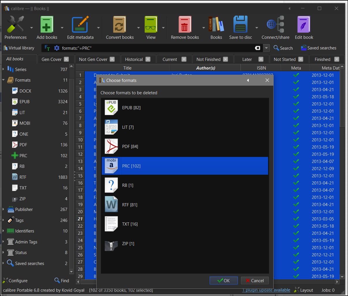

While i was trying to send my books to my Fire Tablet, i got an alert they were in the wrong format. it offered to convert them. I did it but noticed i liked the other format better. i have an app that can read that format. I went to remove the AZW format. i can't figure out how to remove it in bulk. i don't want to have to through all 200+ books individually to remove it. When i click on edit in bulk, i don't see the option to remove/recycle.
All help will be appreciated!

Click the format you don't want in the Tag Browser, select all the books it finds (Ctrl+A), click Remove files of a specific format from selected books in the Remove books drop-down action list, select the format you don't want, and then click OK.
This may help Click image for larger version

Thank you Better Red! That solved the issue. Very much appreciated!!
