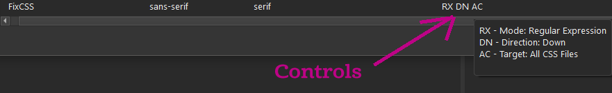

Open Saved Searches windows and edit Controls for FixCSS.
Set at least three of them:
* Mode (Normal, case Sensitive or RegEx), be sure to set the Target (All CSS Files) and the Direction (Down).
EDIT: KevinH outlined details with which I fully agree.
