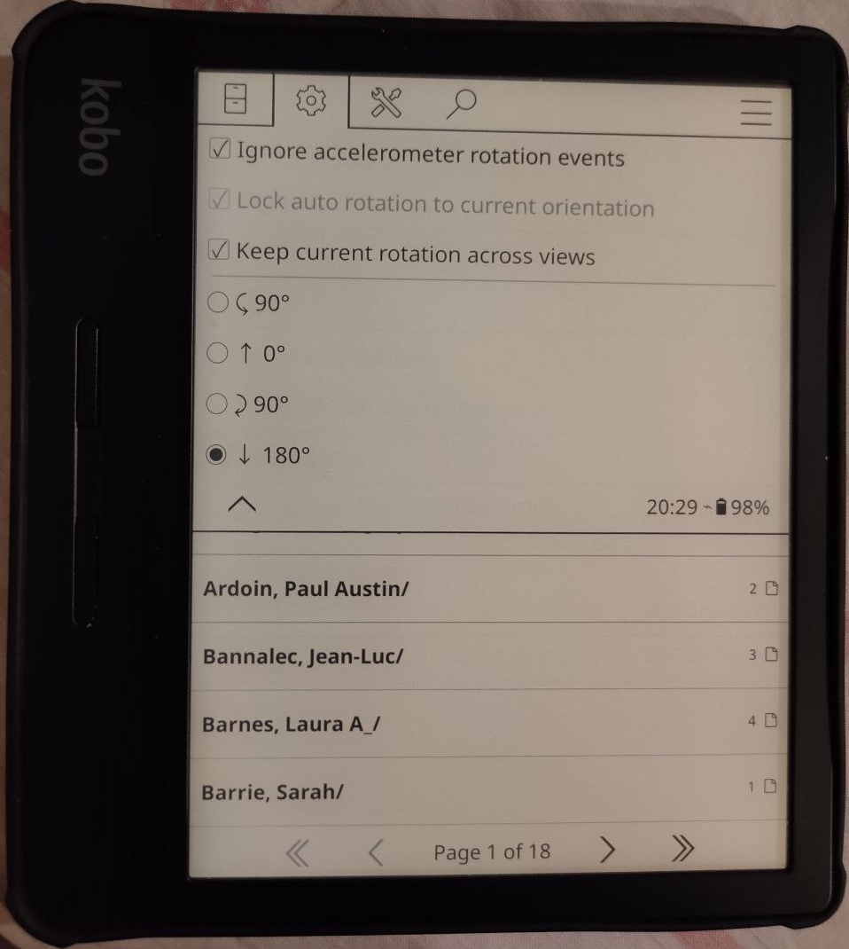

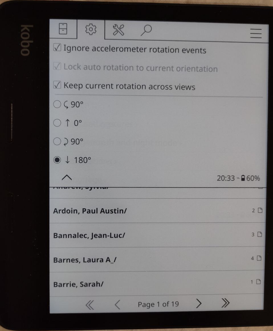

I was certain that my locked rotation settings used to persist after a power off? I powered on my backup Libra H2O and was surprised that while Nickel respected my locked rotation, KOReader didn't. So I powered off my Sage and discovered the same thing, despited the settings being ias shown in the attachments. Has this always been the case, and/or is there any way to have the rotation shown persist even after powering the devices off?
ID:	197031   Click image for larger version

@Uncle Robin: I'm not sure I see anything wrong here: 180 (Upside Down) *is* the lefty orientation?

@Uncle Robin: Yup, that was a regression since roughly last week .
https://github.com/koreader/koreader/pull/9606

This! My two screenshots were taken after resetting the orientation, to show the screen rotation settings - which do persist after power off. It IS the "lefty orientation" but it only looks correct in the shots because I'd selected '180' after powering on.

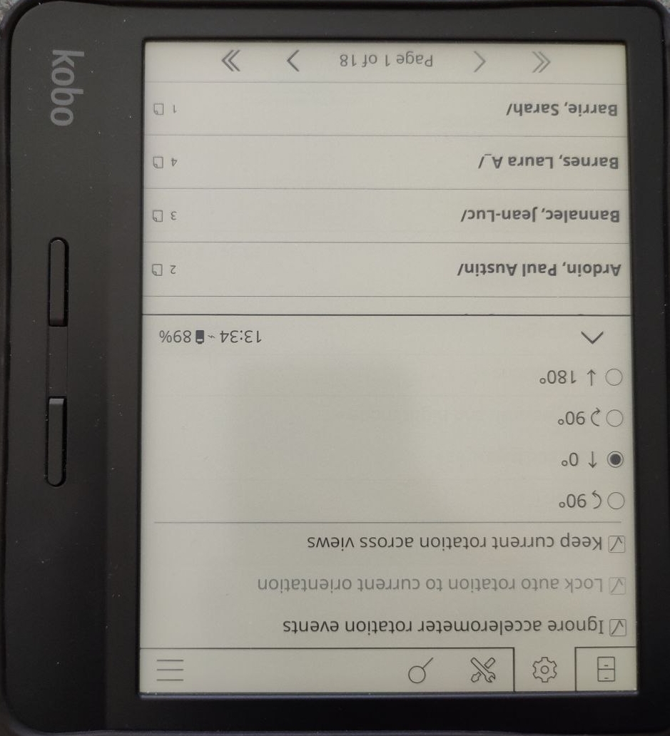

This is what I get too - as in the attached screenshot taken immediately after powering on, BEFORE correcting the orientation this time

@Uncle Robin's issue should be fixed in today's nightly. (And, assuming your screensaver mode supports portrait orientations (which... they all should ;p), the reboot/poweroff screen will now also follow the lefty Portrait orientation instead of hard-resetting to canonical Portrait).
I... still don't understand @BiliBug's issue, because the screensaver should already be following the lefty Portrait orientation, so nothing should be rotating anywhere... Unless you're using a funky screensaver mode or were reading in Landscape?
(But, to answer the final question: yes, we can't actually ask the system "what's the *current* orientation?"[1], we only get "I just rotated <which way>" events as they happen, so we can't really resync to the actual orientation on resume, we have to go back to what we think it used to be *before* suspend).
