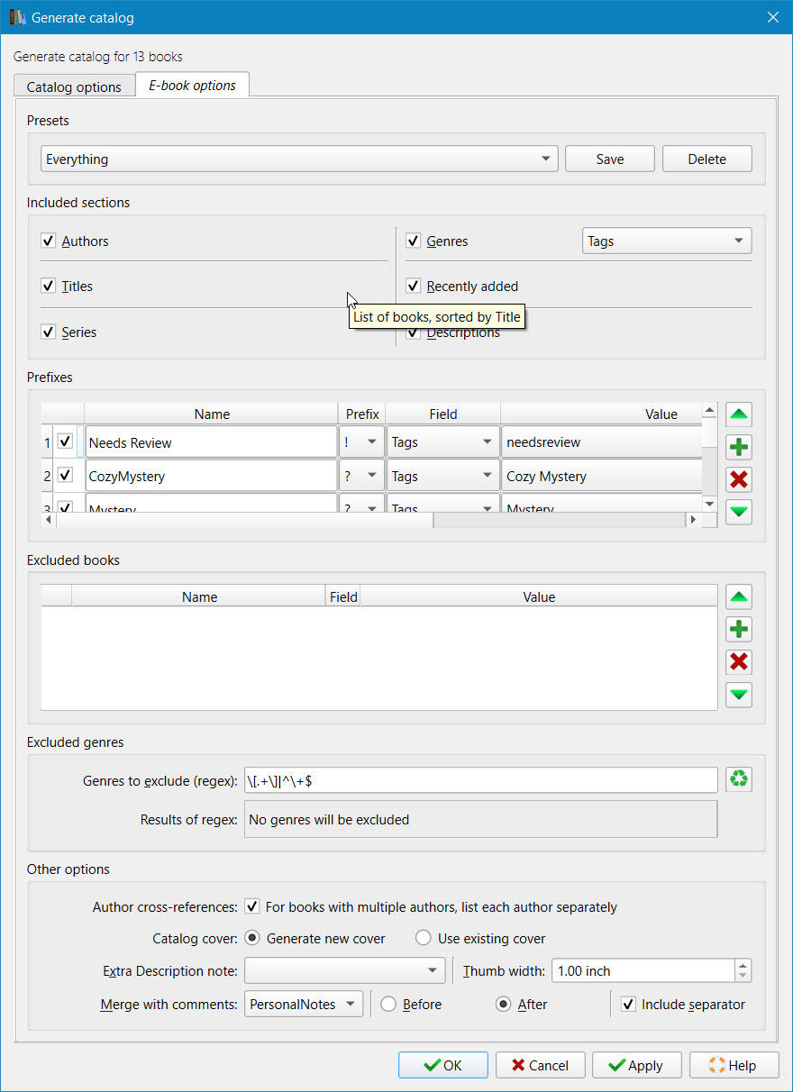

I've also included a screen shot of the options I used for the catalog that should list all of the books.

Following up on my previous post, I unplugged the kindle from the PC and re-ran the catalog. The same books are missing from the catalog.
Is there some debug info I can collect to see what's going on?

Are the excluded books present in the main calibre book list when you generate the catalog?
Old 09-13-2022, 10:35 PM   #4
Posts: 45,620
Karma: 28549044
And you have a bunch of exclusion rules defined. Try running without those.

I am curious:
1) both screens show 13 books. Would be interesting to see the list of books in the title section of the table of content. Perhaps you like to add a screenshot
2) is there any reason why the book is not added to the device? For sure it should be in the catalog anyhow, also calibre do not know which books are on which device when it is unplugged. The only specific I can see, is the date. The book is from yeasterday.
3) when you run the catalog creation, do you use any marking/selection or search/filter or virtual library?
