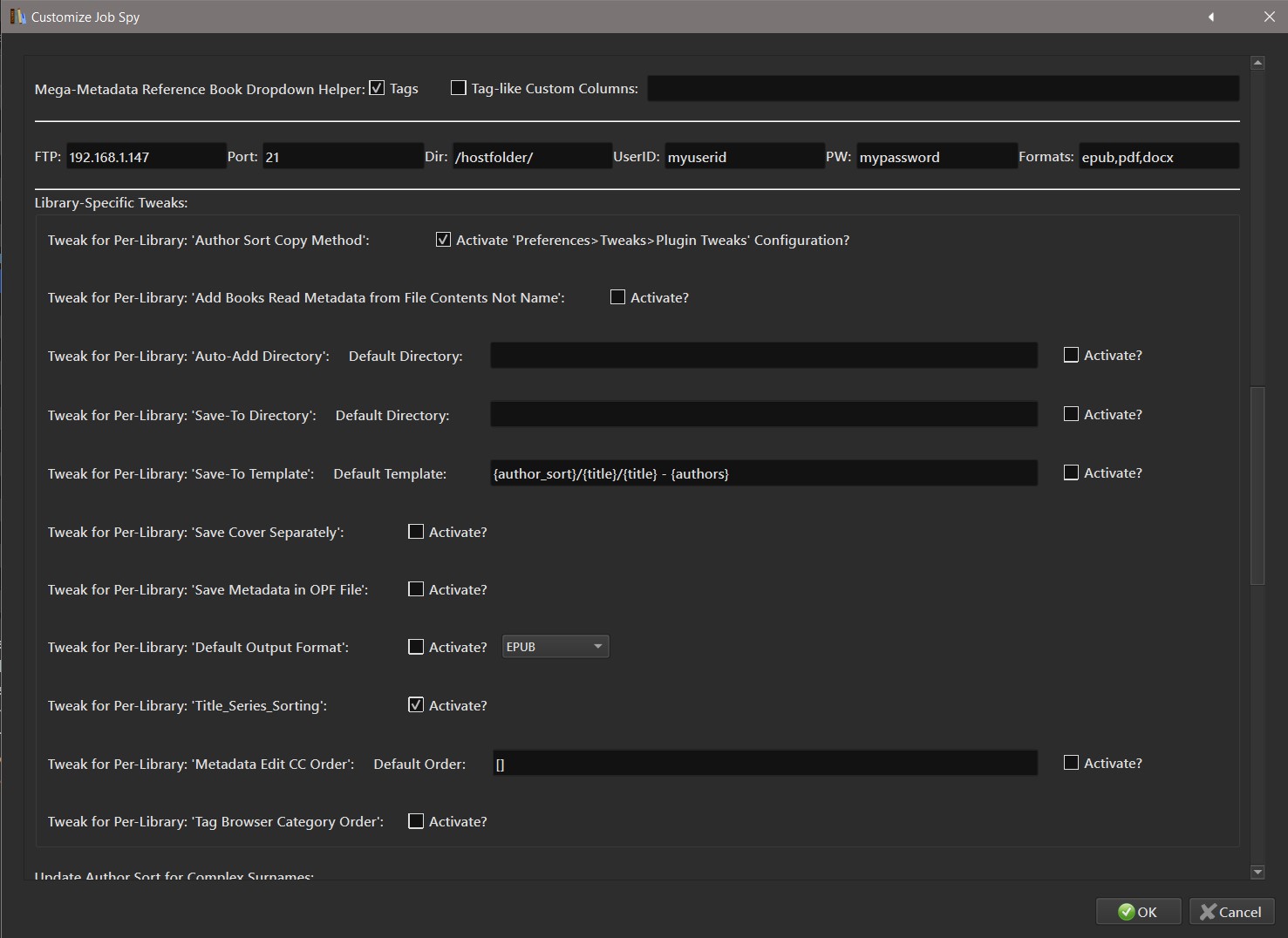

The JobSpy plugin has a number of Per Library settings that override the global defaults, viz:
Name:	Screenshot 2022-07-29 085541.jpg
Hover over the Tweak label for details on how to use, some require plugin specific tweaks, which are here:
Name:	Screenshot 2022-07-29 090314.jpg
I use the Tweak for Per-Library: 'Author Sort Copy Method':
Make sure you check the activate checkbox.
