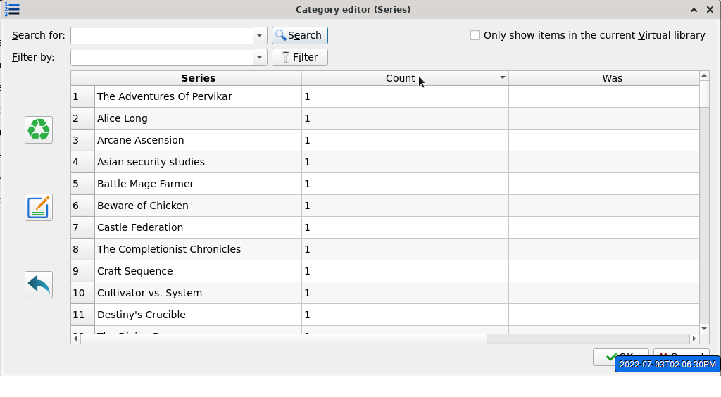

Thanks for the suggestion! What I was looking for something closer to this view:
However in this view I can't actually manage the books or see details of the books. I wanted to create a search that was based on the data as shown in the screenshot but could be managed as a saved search.

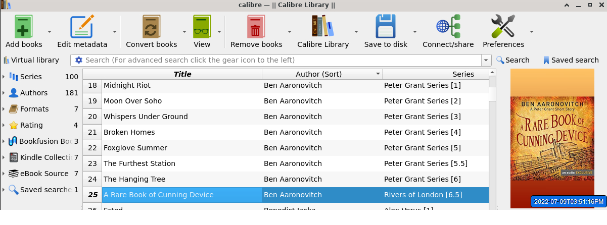

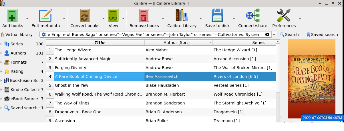

You are welcome. I do wonder about the "false positives". What is it finding that it shouldn't?
If you look at the screenshot below, you will see it is listing "A Rare Book of Cunning Device" [Rivers of London 6.5] as the only book in the series in the library:
However, if I clear the search results, you can see there are actually several books in the series in the Library:
That's the one I've spotted so far (though I haven't been validating each result).
Attachment 194808
Attachment 194809
Looking at your images, most of the books are in the "Peter Grant" series. #6.5 is in the only book in the "Rivers of London" series. Should the series name for #6.5 be changed to "Peter Grant"?
There have been requests over the years to be able to find books using criteria that span the library, e.g., authors contributing to more than one series; series with more than one author, authors that appear only as co-authors; singleton series, tags, publishers, etc. 'Series with one book' was the easiest example to make because I had just done something similar in Action Chains.
The series is actually called Rivers of London. All the other listed as Peter Grant are incorrect.
I think at some point this will called the Peter Grant series(?). I typically take Series names via the Download Metadata plugin or by searching Goodreads. So it's not typically my own invention when it comes to Series names.
Either way my thanks to you & chaley for spotting the problem with the mismatched series names, I've corrected the other books in the series to follow the right name and that's fixed the issue with the Action Chains search.
