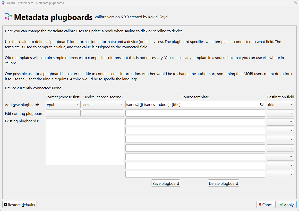

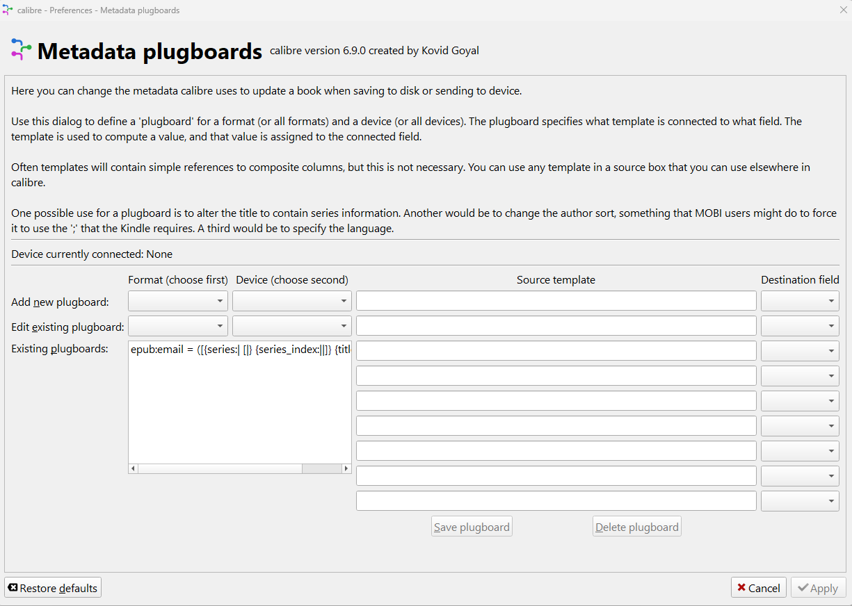

I'm not certain but the problem is that when I was playing with this a couple of days back, I created a metadata plugboard and it seemed to work for me with the book showing up on my Kindle as [Series #] title. However emailing the book to myself did not show the filename as being changed and quite a few comments have been made suggesting that the title was derived from the filename so I am not sure as to how or why it worked. I suspect from previous messages that Kovid is modifying the filename when sending to a Kindle email address.
I've added a couple of images of when I created the metadata plugboard.
ID:	198108   Click image for larger version
