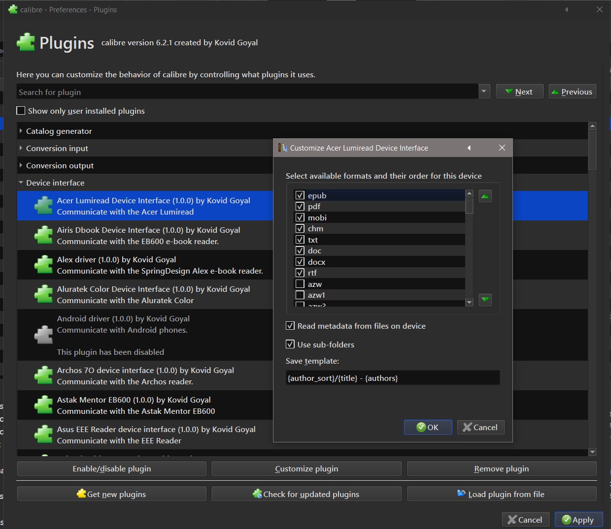

Then when I send books to the device I'd like to send pdf files if they exist as well as epub.
This can be configured via the Device interface plugins, viz:
Name:	Screenshot 2022-08-01 084900.jpg
