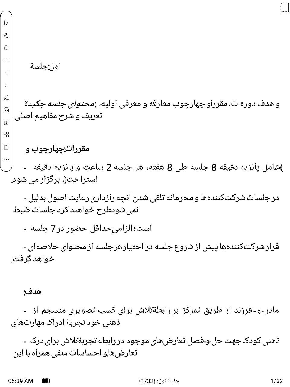

5. Persian words in Docx documents become disarranged in NeoReader V3.0. Modifying the Typeface and Encode Options (to Arabic) will not correct the disarrangement. Is it any solution?

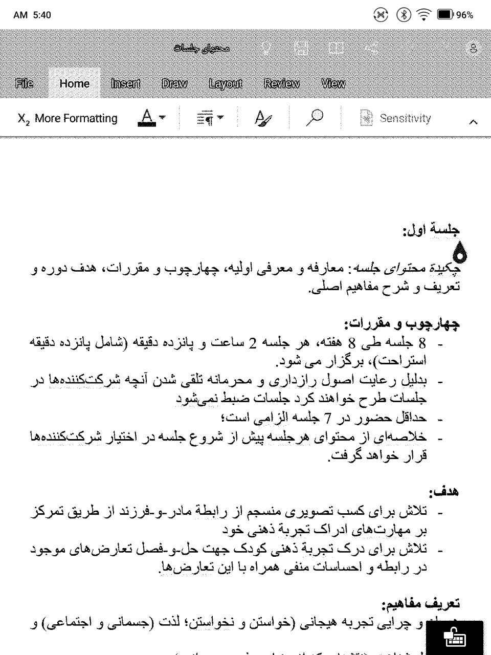

5. Yes, I tried different fonts, but it didn't solve the problem. I attached the Neoreder and Word screenshot (in Word the text is arranged correctly)

Well, Neoreader is not respecting RTL layout.
Without highlighting or making this about a single word I don't have a clue.
Is that document a mixture of languages?
I know neither Arabic or Persian, but I do know enough to work with Chinese or Cyrillic and Unicode problems.

The built in docx support isn't great. You might have better luck converting the docx to ePub and using the V2 engine but I don't read Arabic so I'm not sure if it's any better. For Japanese RTL works OK in epubs.

I tried the Arabic Epub 3 sample and with the V2 engine it does seem to do RTL and look more like that Word screenshot. Can't comment too much since I can't actually read Arabic so there could be other issues. The test epub posted also seemed OK but that's pretty basic.
