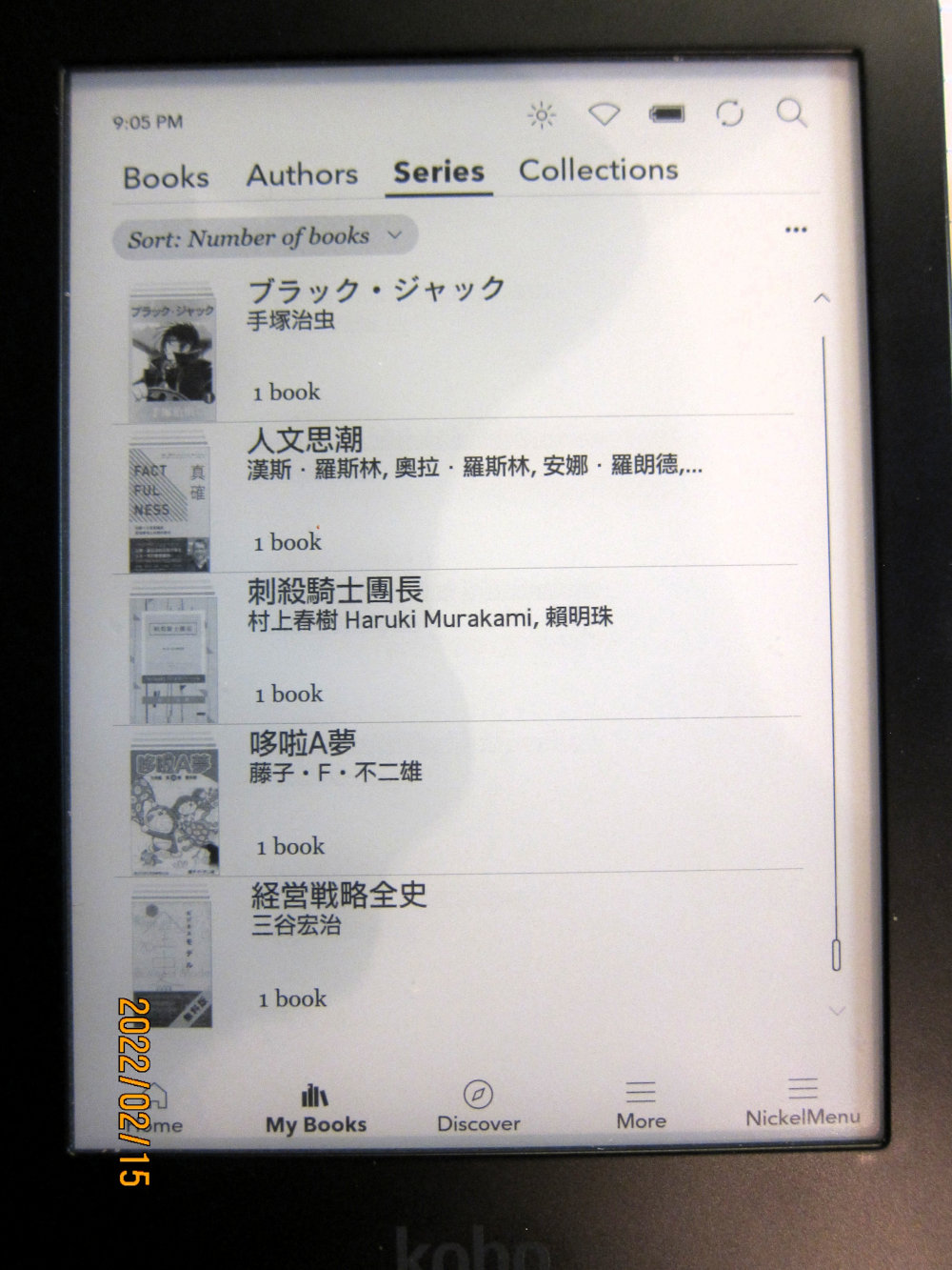

Just had to reset my Clara HD and after updating it with Calibre am noticing some ghost series which don't correspond to any books which have ever been on the device. The books don't show up on the device list on Calibre, or on the device.
It's really weird and puzzling. Any ideas on how to get rid of these things? They're like mosquito bites.

The Series tab is built from books on the device. If you open the actual series, you will see the books that are in that series. Are you saying that the books do not appear when you open the series? If they do not, check what the filter is set to at the top left. The simplest guess would be that they are previews. And that the filter is set to something else. And calibre will not show previews unless you select the option in the driver configuration.

Davidfor, thank you for reminding me about the "previews". Because I run with a patched system, only use Calibre, and never enable wifi, they never have been visible. The Calibre driver settings were right (previews box not checked). Following on the suggestion you gave in this thread Kobo books not deleted from device, I reset the account on the Clara and then resynched with Calibre. The ghost series are gone now. Whew.
Thank you!
