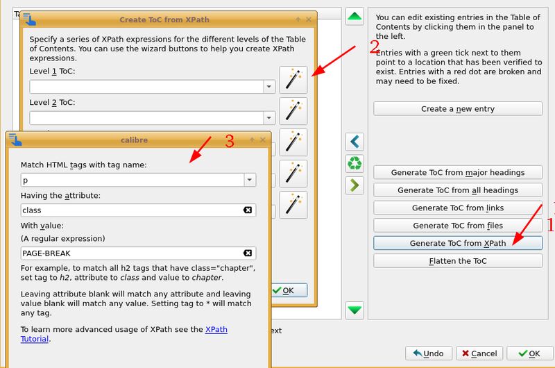

Use xPath (see screenshot)
But the title of the entry, in the ToC, will be the content of your paragraph, so, in your case, it always will be "*", unless you put by regex an hidden text (with attribute display: none) inside your paragraph.
But if the title of the entry, in the ToC, will be the content of your paragraph, so, in your case, it will be always "*", unless you put by regex an hidden text (with attribute display: none)
Thank you for your reply. Unfortunately, it did not work. The result was one entry in the TOC, (Untitled), which links to the original problem - the same as "Begin Reading".

Originally Posted by Skydog View Post
Unfortunately, it did not work. The result was one entry in the TOC, (Untitled).
It's because the content of all your breaking paragraphs is always "*".

After the Xpath box, use the Wizard icon. (it opens another layer)
fill in the boxes:
Tag type (* is any, but I prefer to narrow it down to p)
attribute class
value: PAGE-BREAK
accept, this creates the xpath
Run that
fill in the boxes:
I've explained exactly this in the screenshot of my first message. But it doesn't work since the title of every entry will always be "*", so calibre criate only one entry in the ToC (it doesn't duplicate the entry if the title is the same) [note 1]
That's why I've suggested to add a hidden text inside the <p></p> tags, so it will create one entry for every PAGE-BREAK, CN and CO. That's exactly what is doing the regex-function I wrote for him.
___________
[note 1] I realize just now that there is an option "Do not add duplicate entry [...]", and that unchecking this box solves the problem :-/. Anyway, it's nicer to have some numbers in the ToC than only stars at all levels.
