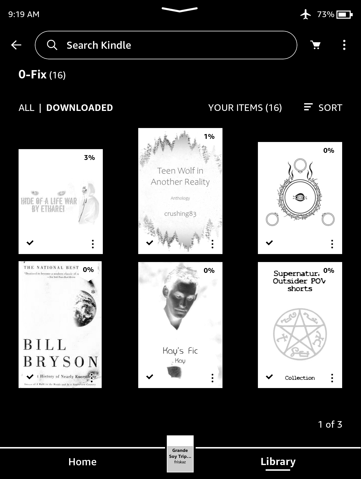

I've recently been working on a project to provide cover art to all of my downloaded fanfiction. I have noticed that on my Oasis, which I always have in dark mode, several of the covers always appear inverted in the grid display in the library.
The covers in question are all very dark - probably at least 80% black, if not 90%. They all appear normally in day mode. At least one is from a traditionally published book. They all appear correctly in the little thumbnail at the bottom of the library display. Some of them also will not show up when the device is off, even though I have that enabled (but 10 of 16 will. Five correctly, five still inverted).
Some of them I'm willing to replace, but some I'm very attached to as-is. Anyone have any clue how to force them to appear normally (besides switching to day mode)? These are all non-DRM files I can edit at will. I use the Calibre editor.

How did you add the covers? What format eBook did you upload?
Honestly, this is most likely the wrong forum for this--this subforum is about the making and building of Kindle eBooks, whereas the Calibre subforum or the Kindle reading/using subforum might have better answers, but...the gang here can try.
Pretty simply, my take on it is that the device is simply reading the b/w on the cover and inverting it BECAUSE it's in Night mode. Now that being said, I would have thought that the metadata would have prevented the device from doing that--how, again, did you add the covers, exactly? You say you're using Calibre's editor, but Calibre doesn't have a MOBI or AZK/AZW3 editor; it has an ePUB editor. So...how'd you make these and how did you add them?

How, exactly, did you build the files and how/where did you add the covers? Did you add those via Calibre's CONVERSION program or this AZW3 editor that you're talking about? This AZW3 editing program is something different than the "conversion" engine, is that right?
(Pro tip: honestly, it's easier to work in ePUB and then do a final MOBI conversion and sideload that to a device, but hey, you do you.)
Can you tell me, please, how you added the cover to the file, precisely? I'm asking because it matters--if you added it like an image, it'll reverse. If you added it like a cover, it shouldn't.

It looks like dark mode those not invert graphics and/ or covers.
To me, it looks as though Dark mode did, AS IF it were an embedded image, rather than a cover.
