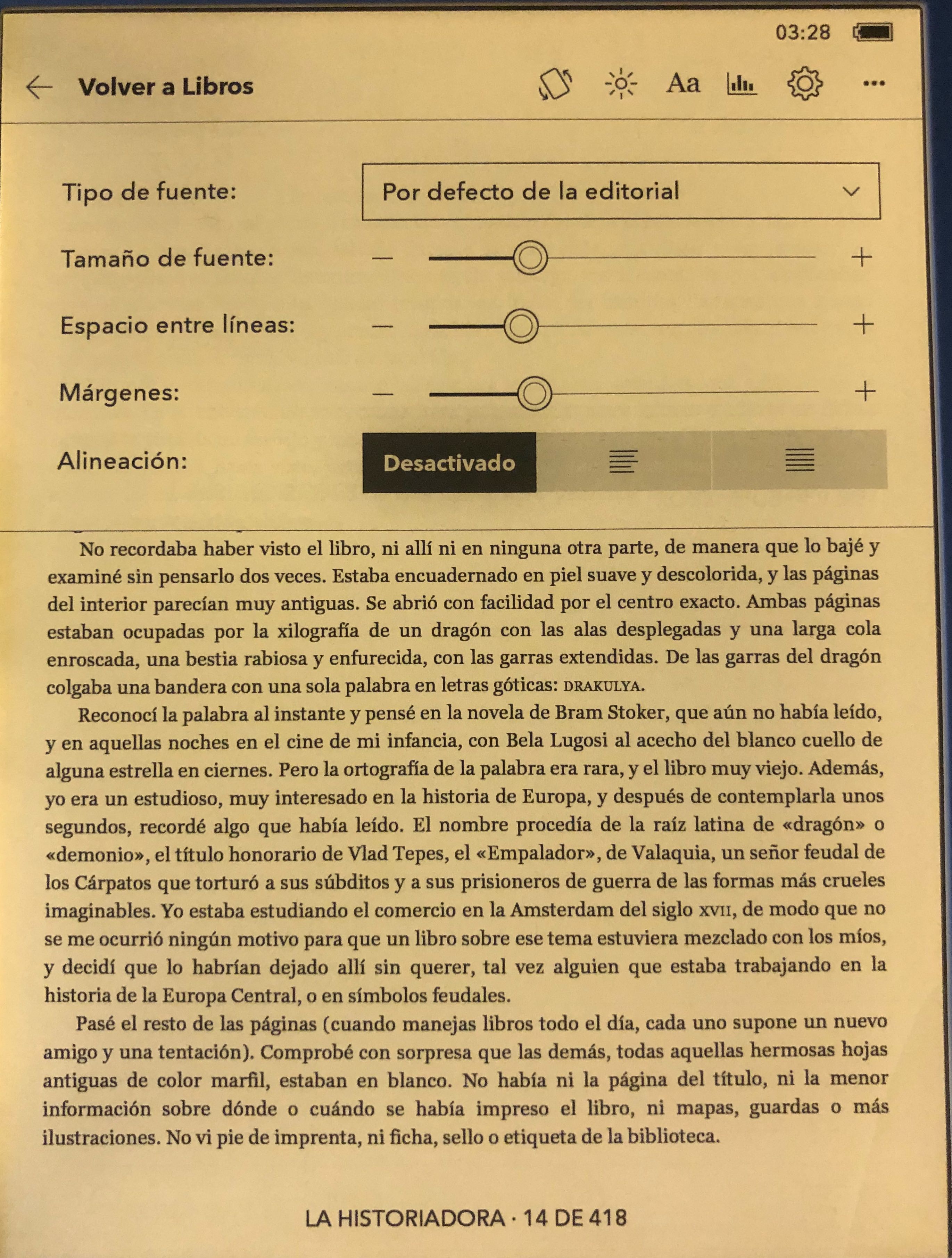

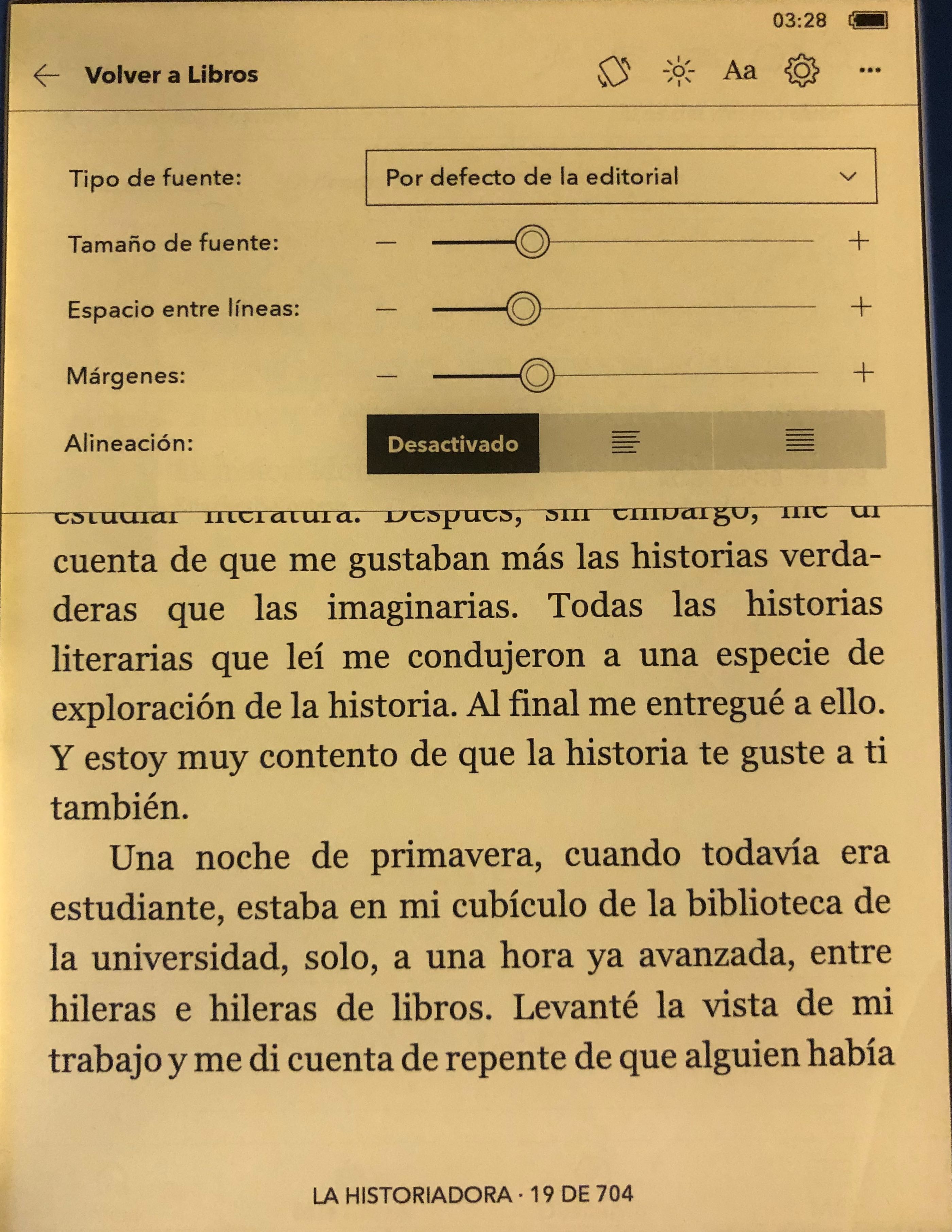

  • The first thing I notice is that the Kepub and ePub books are rendered quite different despite having the same font size and margins on the Kobo. Is this right or did I mess up with Calibre settings? Left image is Kepub and right is ePub.

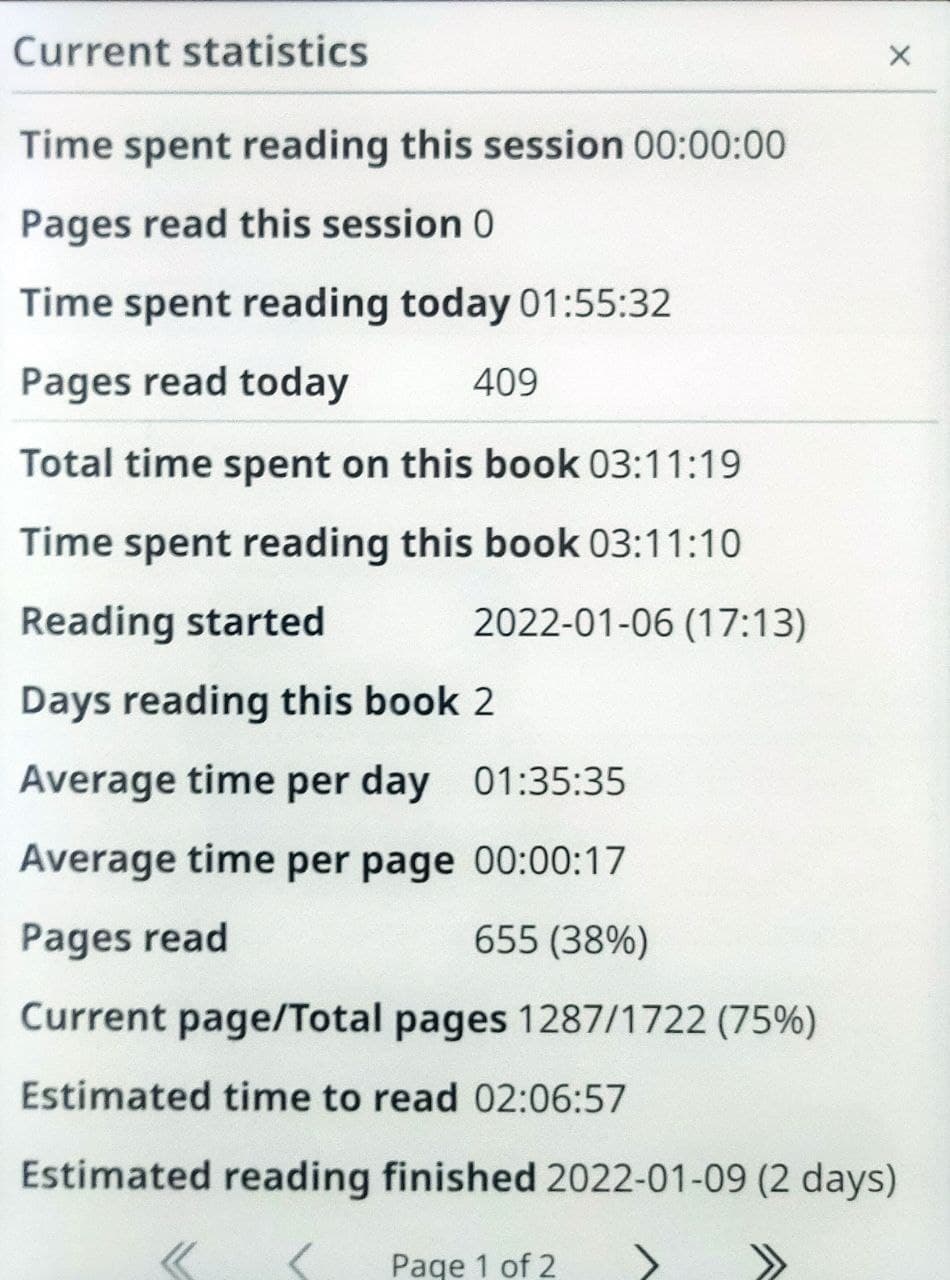

  • I can't see any statistics with ePubs. Is this normal? The little bar that appears right-up corner with Kepubs doesn't shows with ePubs. I also noticed that sometimes, both in ePubs and Kepubs, current page number doesn't always change with each page turn or flip.
  • I see that font, margins and spacing customization are saved individually by book. This is the opposite of Kindle because with Kindle it applies the changes to every book on the device. I understand that this is a normal behavior in Kobo software, right?

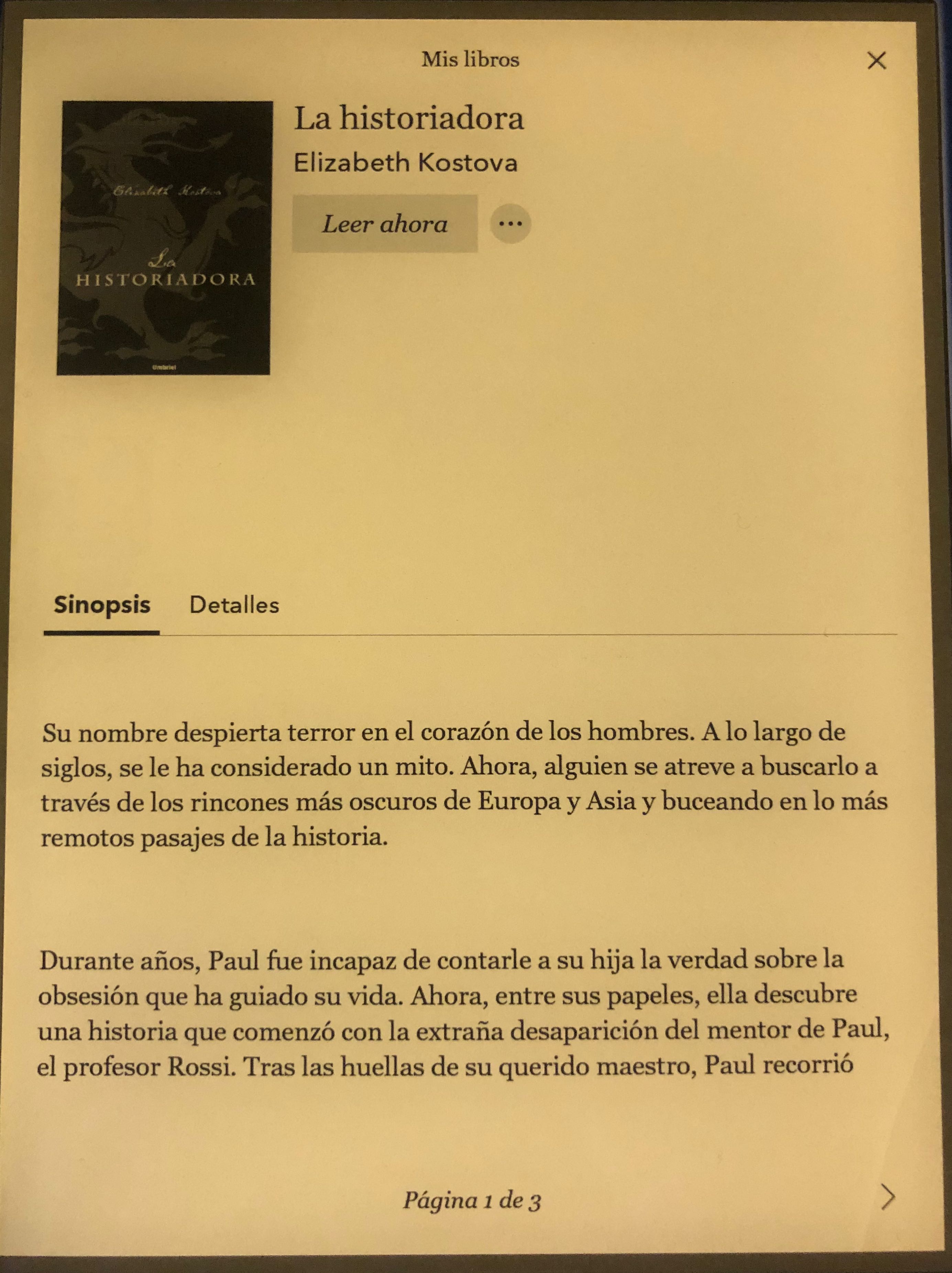

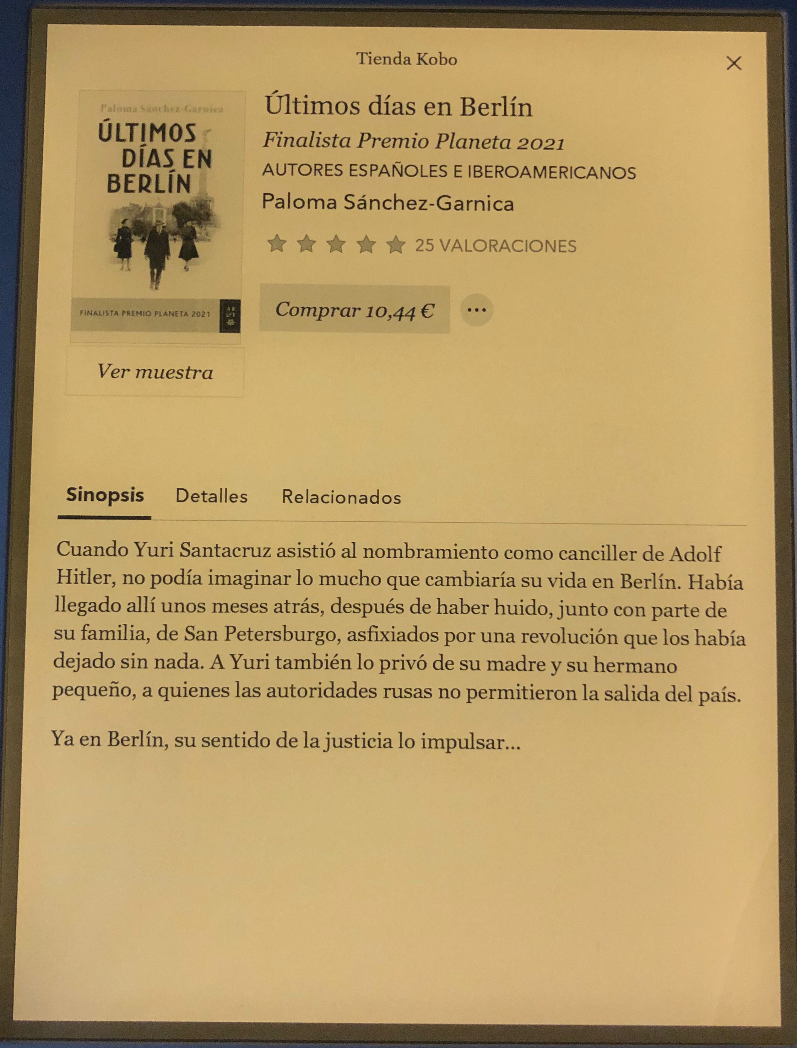

  • When I go to the book details on the Kobo (I click the 3 dots then "See details"), there are to tabs to see the synopsis and the file details. In the synopsis there is a weird double spacing despite having it right on Calibre. If a check a book on the Kobo Store it happens too (despite showing right the first second it is loaded and then change to show double spacing), so I am assuming it's the way it is, right? First picture is a my book in my library and the other two when I open a book on the store and how it changes a second later.

  • Last, it is possible to show things like tabs or ratings on the details section if I add them to Calibre?

1. Yes, epubs and kepubs have different font sizes, unless you apply a patch that fixes it
2. Right, no stats with epubs
3. Yes, settings are saved for each book
4. Also true. To change this with a book sideloaded from Calibre, change the <p> tags to <br> tags in the comments section (the html view). Unfortunately it must be done manually with each book, as the bulk option won't stick
Thank you. Your help means a lot.
If these features are important to you and you read mostly epubs as opposed to kepubs, you may want to consider giving KOReader a try. I've attached photo of the stats page for my current read. Also, this thread shows how to set persistent defaults across all books
No in-book stats for epubs. The stats shown on the Activity->Reading Stats page are done for both.
Unlike most places that use HTML syntax to display text, the synopsis shows any carriage returns that are in the code. And the editor that calibre uses for the comments puts them in between p tags. Using br tags does solve it but, it is ugly. Using a metadata plugboard on the comments will remove any extra whitespace and the synopsis should display without the extra line spaces. It should work with just:
{comments}
The reason for "should" is that there have been changes in template language recently and they affected this. And my metadata plugboard is a lot more complex and explicitly strips the extra whitespace characters.
If that doesn't work, the following should:
program:
re(field('comments'), '\s+', ' ');
For anyone who is interested, I use:
program:
comment=field('comments');
rating_str = test($rating, strcat('<p><b>Rating:</b> ', rating_as_stars($rating), '</p>'),'');
kobo_last_read_str = test($#kobo_last_read,strcat('<p><b>Last Read:</b> ', $#kobo_last_read, '</p>'),'');
word_count = test(field('#words'),strcat('<b>Word count:</b> ', field('#words')),'');
page_count = test(field('#pages'),strcat('<b>Page count:</b> ', field('#pages')),'');
counts = test(strcat(word_count,page_count),'<p>','');
counts = test(word_count,strcat(counts,word_count),counts);
counts = test(word_count,test(page_count,strcat(counts,' '),counts),counts);
counts = test(page_count,strcat(counts,page_count),counts);
counts = test(strcat(word_count,page_count),strcat(counts,'</p>'),'');
extradata = strcat(rating_str,kobo_last_read_str,counts);
comment=strcat(comment,test(extradata,strcat('<hr/>',extradata),""));
re(comment, '\s+', ' ');
Which puts the comments followed by a line, my rating for the book, when I read it, the word count and the page count. The complications are so that if the values do not exist, there are no errors, and nothing is added for that item.

For the comments section changes, where I need to write the code? In Preferences - Advanced - Template functions? It is possible with those functions add details like ratings to the details sections of Kobo? Or Calibre only can write in the synopsis section?
It is a "metadata plugboard". Hence it goes in the "Metadata plugboard" section of the calibre preferences. I can't find a good description of how to do this, so here is a hopefully understandable one:
  1. Open the "Metadata plugboard" page of the preferences.
  2. In the "Add new plugboard", select "EPUB" in the formats drop-down list and "KOBOTOUCHEXTENDED" in the device drop-down list.
  3. Under "Source template" paste the template to be used.
  4. On the same lines, select "comments" in the "Destination field".
  5. If you need to change more than one metadata item, use the next line. Make sure you select the correct destination field.
