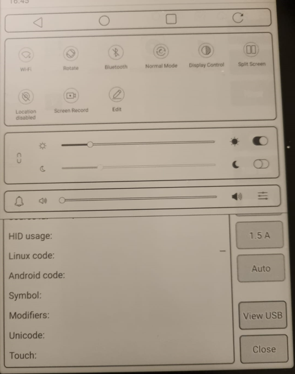

I didn't had a chance to try it because I sent it to the lab.
When they returned it back to me today, they said it is a screen problem
I dont know exactly what they cheked. he told me that he tried to put a diffrnet screen (But not a compatible one) and there still was a problem nut maybe if the right screen will be replaced it will work.
I instlled now the UsbMode-2.3.apk
when I poke the screen with the pen I see the coordinated
when I use y finger nothing
and when I dont touch it there is also nothing
(But the toolbar does not pop out )
faina is offline   Reply With Quote

Now I got the toolbar to pop when im in the app but it doesnt show coordintes

attached photo
