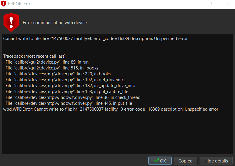

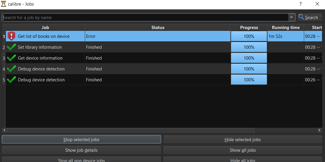

I have been getting the same message for the past few Calibre versions, the message is "Error communicating with device".
My OS can detect the Kindle when I plug it in with USB and Calibre can detect the device when plugged it.
Calibre can 100% get device information and set library information
Calibre gets an error getting list of books off device.
The Error code I am getting is:
calibre, version 5.14.0
ERROR: Error: Error communicating with device
Cannot write to file: hr=2147500037 facility=0 error_code=16389 description: Unspecified error
File "calibre\gui2\device.py", line 89, in run
File "calibre\gui2\device.py", line 515, in _books
File "calibre\devices\mtp\driver.py", line 220, in books
File "calibre\devices\mtp\driver.py", line 192, in get_driveinfo
File "calibre\devices\mtp\driver.py", line 182, in _update_drive_info
File "calibre\devices\mtp\driver.py", line 153, in put_calibre_file
File "calibre\devices\mtp\windows\driver.py", line 36, in check_thread
File "calibre\devices\mtp\windows\driver.py", line 445, in put_file
wpd.WPDError: Cannot write to file: hr=2147500037 facility=0 error_code=16389 description: Unspecified error
This hasnt happen before until a few months ago so I am not sure what to do or how to fix it.

That is an error communicating with the device. Usually, this kind of error can be fixed by
following the steps below in sequence. First:
1) Try rebooting both the device and your computer
2) If that does not work, find the files driveinfo.calibre and metadata.calibre on the device
and delete them (you can use Windows Explorer or a file manager on the device itself to do this)
3) Reset the device
If none of those work, you can use one of the wireless communication methods described here:
https://manual.calibre-ebook.com/faq...kindle-fire-hd '''),
