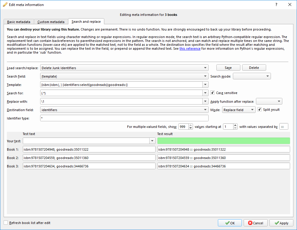

In bulk search and replace (select a few books, edit Meta, tab Search and Replace), I use this template to delete junk identifiers and just keep ISBN and Goodreads:
{isbn:|isbn:|, }{identifiers:select(goodreads)|goodreads:|}
See attachment.
Tip: You can omit the select template and keep the rest to delete every id...

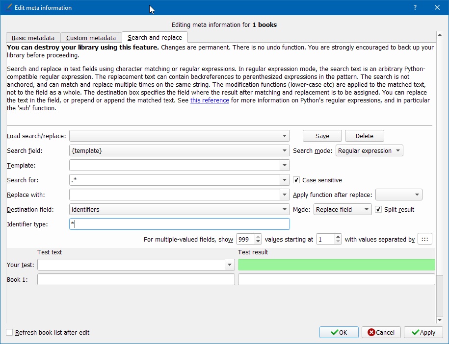

See https://www.mobileread.com/forums/sh...d.php?t=207433
To remove all identifiers, use this

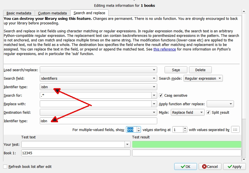

Use the following search & replace. Run it twice, once for ISBN and once for goodreads.
It can be done in a single go by using a template by using list_difference to remove items from the identifiers list. I don't see the point in working this out if one isn't familiar with set arithmetic.
Attachment 172575
I did not think of PUTTING back just ISBN without a value
Once again, the developers have thought of almost every option.
