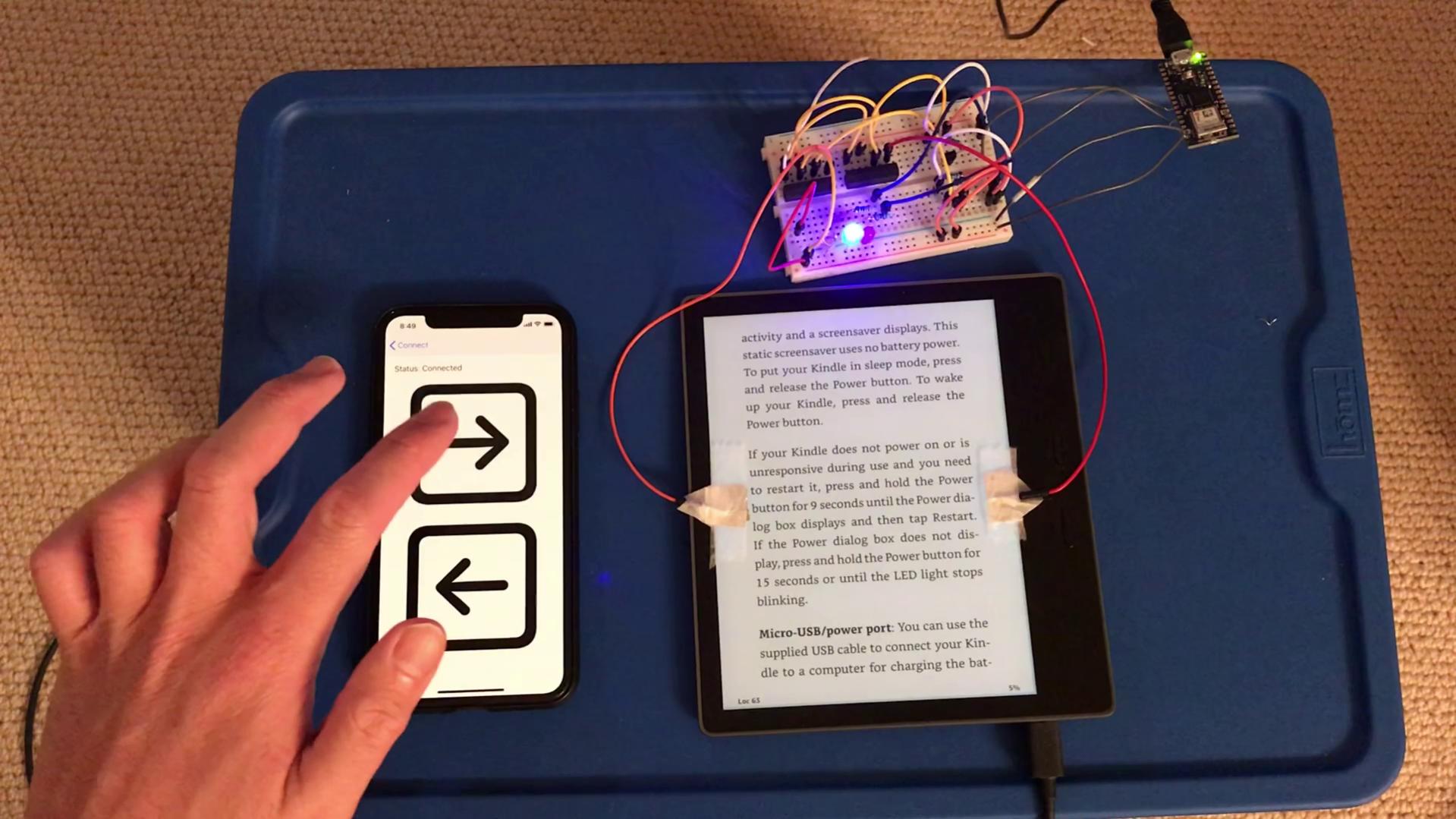

I've been looking for a way to remotely turn the pages on my Kindle. I saw KindleLazy, but unfortunately it looks like the newer Kindles have been locked down pretty tight.
I've been working on a hardware remote page turner that would work for any touch screen e-reader. This prototype is on a breadboard, but it will be packaged into something nicer for real usage.
Right now, I'm controlling it using an iPhone. It could potentially be extended to work with Android and other remotes.
Here's a video showing the core functionality: https://youtu.be/bNfeJDhpqjg
Is there any interest in this? What do you guys think?

I fricking love it. What kind of wires do you have taped to the screen?
It could be built into a paperwhite case, or a oasis sleeve of some wor, and just live in the very corners.
does it just apply 3v or how does it actually trigger the "touch"?

Thanks. Glad to see some people like the functionality. Building it into a case is a neat idea. Right now, the device is on a clip so it can attach to various different readers and even cell phones.
Here's a picture of it being tested on a phone:
Those are normal wires connected to a conductive pad made of tin foil. It works by grounding the screen whenever a page turn is triggered.

This is awesome - would like to get this done to my PW3 build in to the case.
can you please share the details on schematic & how this is possible ?

did some research - won't be best if we can get ground from Adrino & regular it with N channel FET ???
Please share the schematics - don't leave us hanging bro

Interesting...
cosine is using little reed relays to switch the contact to ground.
It's not a bad approach, but then you have the capacitance of the lead wire.
I did a similar thing using forward/reverse pair of diodes directly at the contact point.
I used adhesive copper tape that I punched with a notebook hole puncher.
There are some use cases for this stick-on automation, but I'd prefer not to encumber the screeen.
Nowadays, a Bluetooth clicker is the solution.
You could make a WiFi daemon to listen and inject keys.
You could also make a USB HID peripheral to send PgUp/PgDn.
(You can even just gut a USB keyboard that's in the trash and put two buttons on it.)
You can put in a connector for serial console and connect a little command injector.
You could parallel the hard keys in the device.
Outside of that, I can't think how you could do it.
