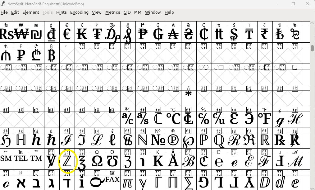

Here's a screen shot showing the glyph at 0x2124 in Noto Serif v2.013.

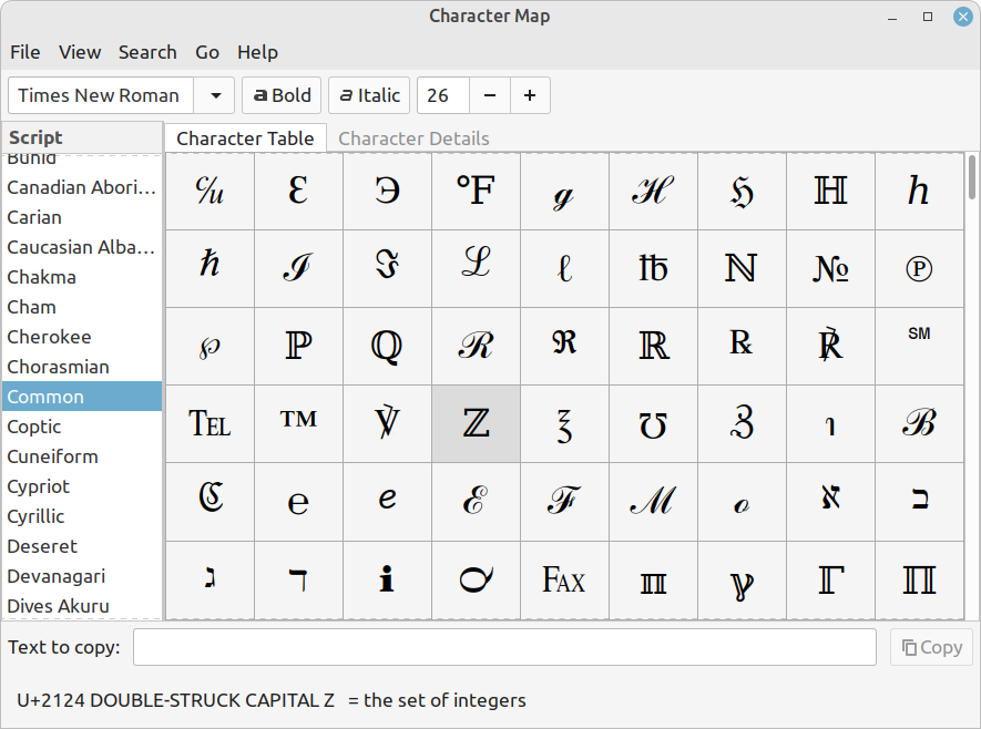

I attach a snapshot of Gnome Char Map. It shows the double struck Z for the Times new Roman font and 'common' script. I get a similar thing with Noto Serif Regular font and the 'common' script.
What exactly are scripts in this context? And what font files do I need to copy to my Clara HD's font folder to get the double-struck Z displayed?

Update: I have finally got ℤ to be displayed by my Clara HD. I copied the font 'NotoSerif-VariableFont_wdth,wght.ttf' to the Clara's fonts folder, then selected the 'face font' in the epub settings to be 'Noto Serif'.
One correction to my earler post. Gnome Char Map should have selected 'View > Show only glyphs from this font'. Then the TimesNewRoman font would NOT have been shown as containing the ℤ glyph; and the NotoSerif font would have.

I've seen that issue before where a freeware font inspection tool would fill in any missing glyphs by using a different font on my computer that had the glyph. I noticed it when I was looking at Courier New and it showed a mass of CJK glyphs. Time for an uninstall.
