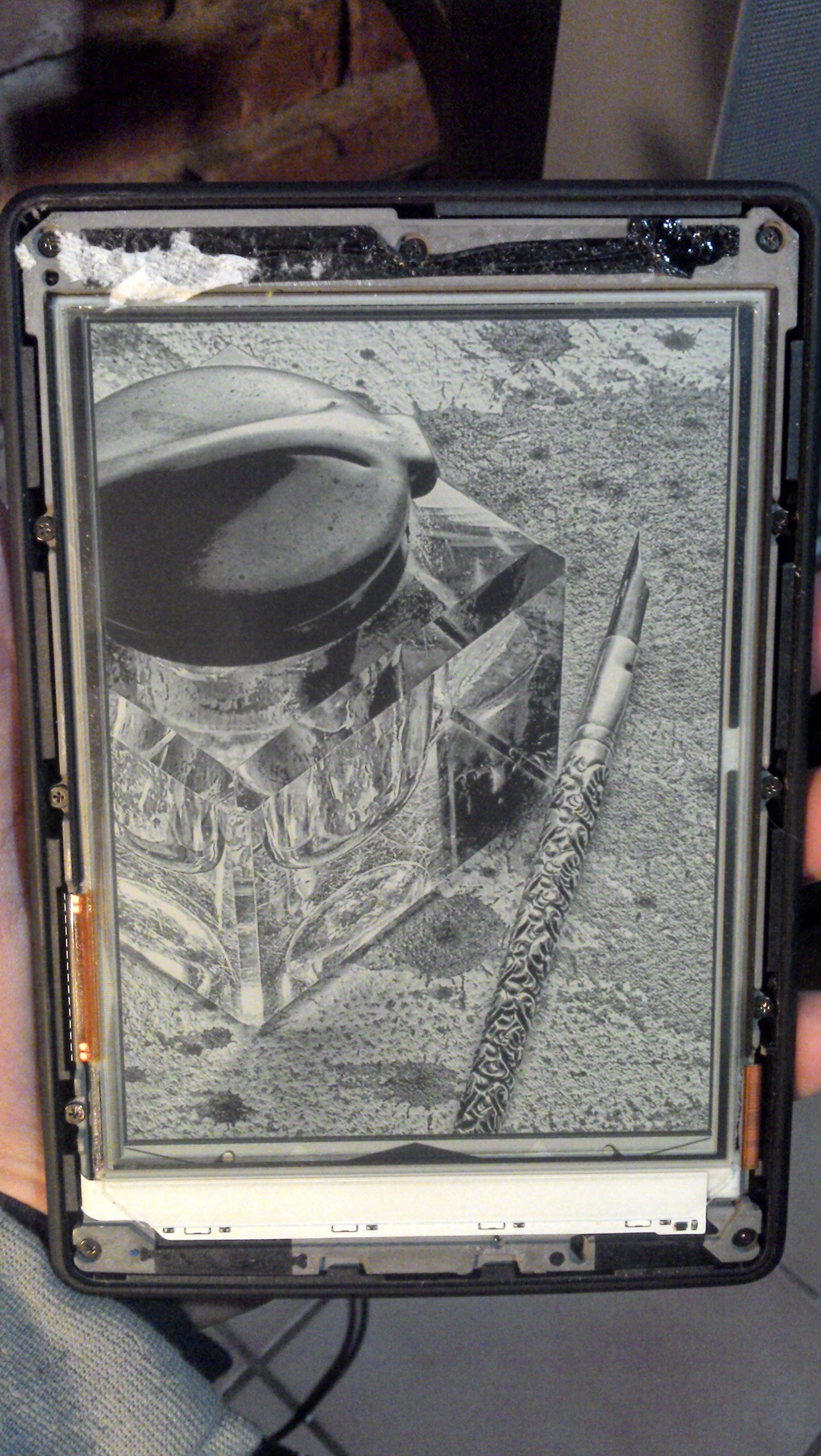

Any chance you can post a picture of the screen? That sounds like it could be a broken screen substrate

I show you here two pictures, as you can see there is any scratch or hit. (I opened a few days a go to see if I can remove the battery but I do not have the screwdriver needed)

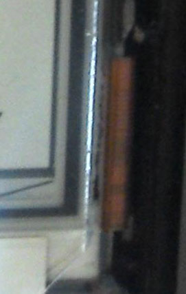

It's hard to tell from the photos, but it looks like something is cracked just left of the ribbon cable just past the lower right-hand side of the screen. Does it look that way in person?

Sounds like a failed electronics of the touch screen. Hard to tell whether the problem is on the circuit board or the screen unless you happened to have another one and could swap parts out to find out which part is bad.
Probably time to get a replacement kindle.

I will post a better picture of that side of the screen as soon as I come home tomorrow.
