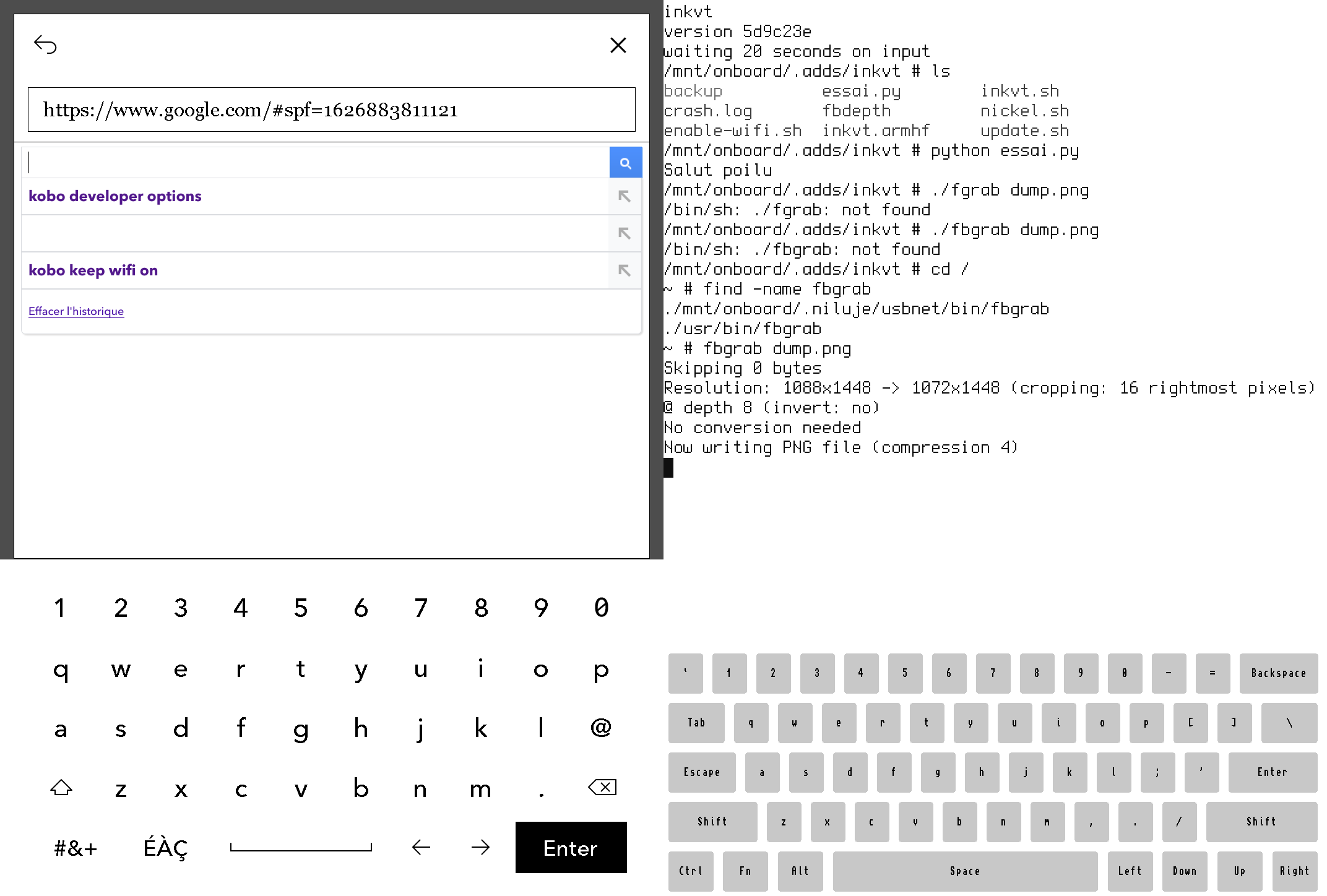

I'd like to use this terrific terminal on my clara but the labels of the OSK are far too tiny to be usable. I join a screen dump that shows the keyboard size of the built in browser and inkvt's. No contest.
I'd love to have the knowledge to fix it myself ...
Could somebody give me a direction please
Thanks for help

That'd take basically re-implementing the way the OSK is currently drawn ;o).
(It's currently poking directly at the font data and unpacking the bitmap by hand, it should be possible to let FBInk do the drawing, and that could include scaling, you'll "just" have to play with computing exact positioning properly).
Or, keep doing it by hand and also (re)implement scaling .
