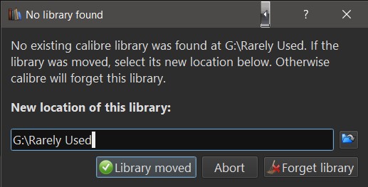

I'd move the rarely used books to a separate library on an external drive, if you try to access the library from calibre and the drive is disconnected or powered down you'll get this:
Name:	Screenshot 2021-07-18 074047.jpg
Just connect/power up the drive and press enter.
I'd use an external hard disk on a USB 3.x port.
