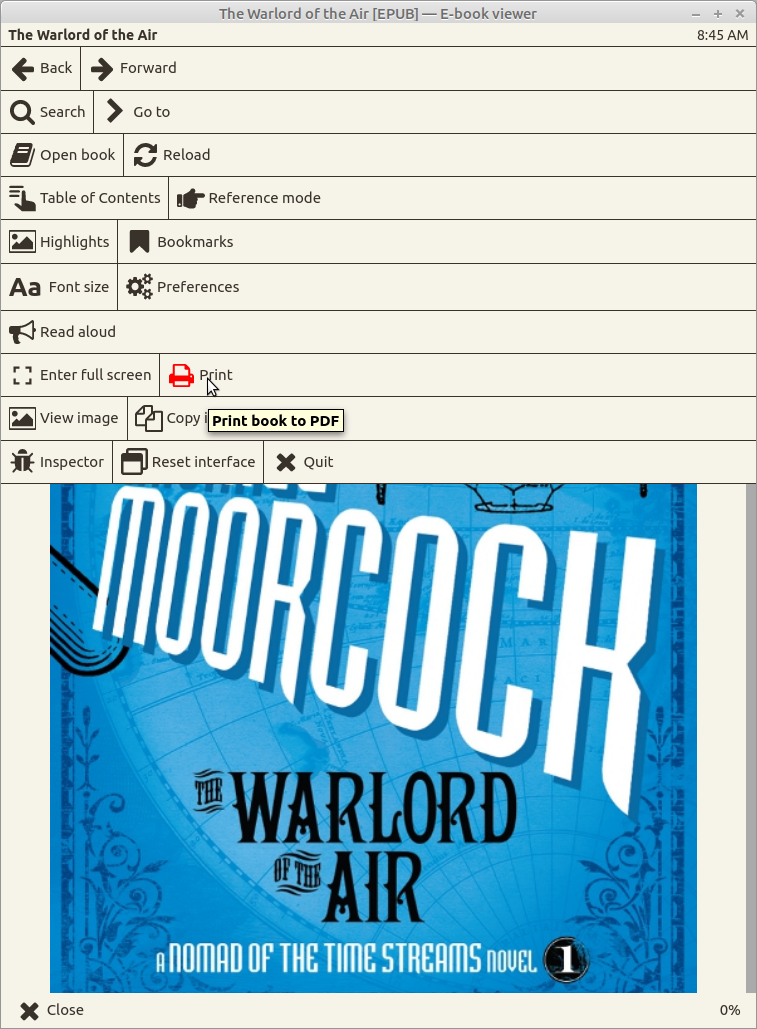

if you want to print the epub then open teh ebook viewer:
Right click on viewer;
click on print;
set your pdf parameters.
Hint use the editor to check that you do not have large font sizes in the epub css.
bernie
Name:	Screenshot from 2021-06-28 08-45-43.png
ID:	187916   Click image for larger version
Name:	Screenshot from 2021-06-28 08-45-07.png

Thanks a lot for such an option.
This is by far the best option I've tried.
Please, when I try this approach, how to adjust the printed .pdf file to have each new chapter in a new page instead of continue everything all after each others?
As it is treating everything as a one single big paragraph.
Thanks
