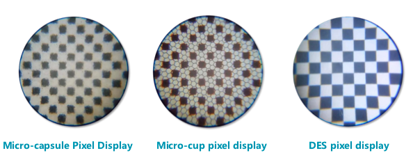

There seems to be a new Eink-type display launching/about to launch. There are a couple of small companies (Topjoy and Reinkstone) saying that they're going to launch colour ereaders with these new displays.
GoodDisplay's new DES (Display Electonic Slurry) looks rather interesting. Like the original E-Ink it uses charged coloured (usually black) particles to form the display. Unlike E-ink, the cells containing the particles are aligned to the pixel electrodes, giving a sharper edge to the pixels. There's a PDF about the technology on their website which has a close-up comparison:
Name:	Screenshot 2021-09-11 at 12.00.21.png
There also a rather poorly done slide in the PDF that suggests the B&W contrast ration of DES is 1:45. I can't find contrast figures for the latest E-Ink Carta 1200 display.
It looks interesting. If the claims of higher contrast and faster response times hold up. I look forward to hearing what they're like in real life when devices eventually ship.

Inherently only good for monochrome. Adding an R G B filter to have colour may be a little better than current filtered eink, but physics and mathematics prove it will still be rubbish without a lot of front lighting.
We'll have a better idea of it when someone releases a 300 dpi mono reader using DES. It may be just a ploy to get round patents and not much different. There is nothing wrong with the sharpness of a PW3, Oasis, Kobo Libra or the 7.8" 300 dpi models.

No color filters, the charged particles are colored. Maximum color saturation probably won't be great, but should still be better than the recent color e-ink improvements.

I believe they do the 'full colour' panels by putting a colour filter in front of the B&W display, like other suppliers.
Colour resolution is quoted at 150ppi, while B&W is 300ppi

So I guess any contrast and saturation gains come from improved fill factor, which certainly had a lot of room for improvement.
