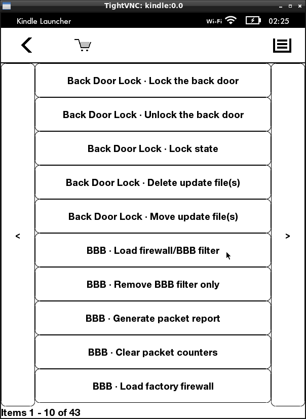

Button Functions
Load firewall/BBB filter (/ == 'with')
Remove BBB filter only (leaves the new infrastructure behind)

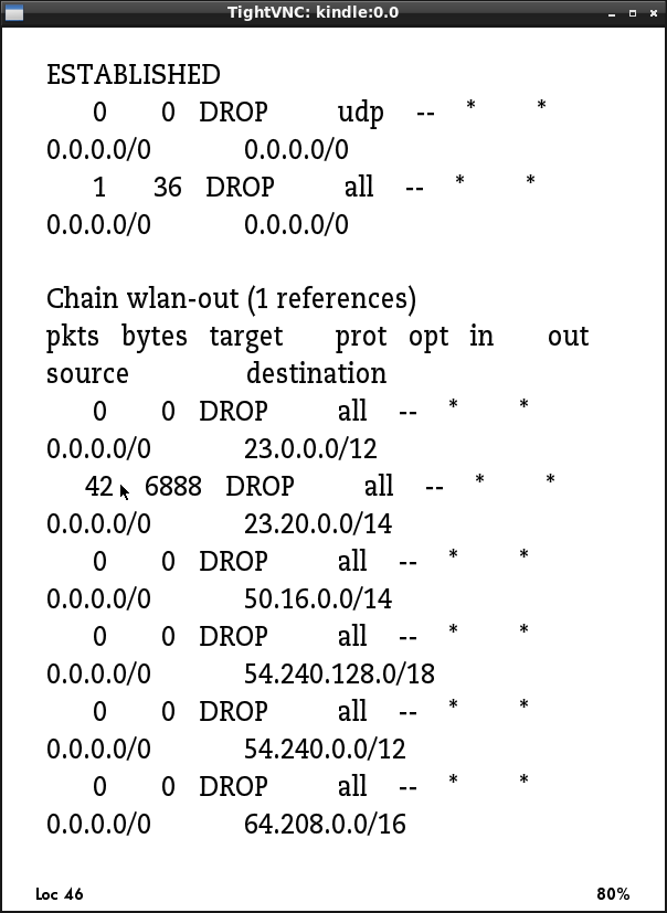

Generate packet report (For the curious, and for inclusion with trouble reports)
Clear packet counters (guess what)
Load factory firewall (re-loads the Amazon factory firewall)

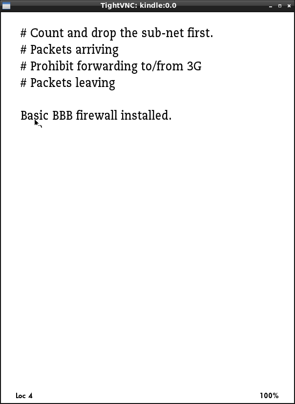

So impressed. Am fiddling now.
EDIT: Excellent.
Only side effect I managed to find so far was applying the firewall while the USB was connected caused it to be ¨re-discovered¨ : ) Just as it should be. No That was a dodgy cable...
Reports work great. Don´t see a down-side yet ; ) All in total result.
Pressed the various buttons. all seemed in order. : D
