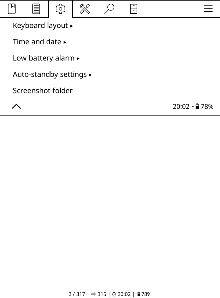

I have only these options now, as in the attachment.
Thank you for the file!
