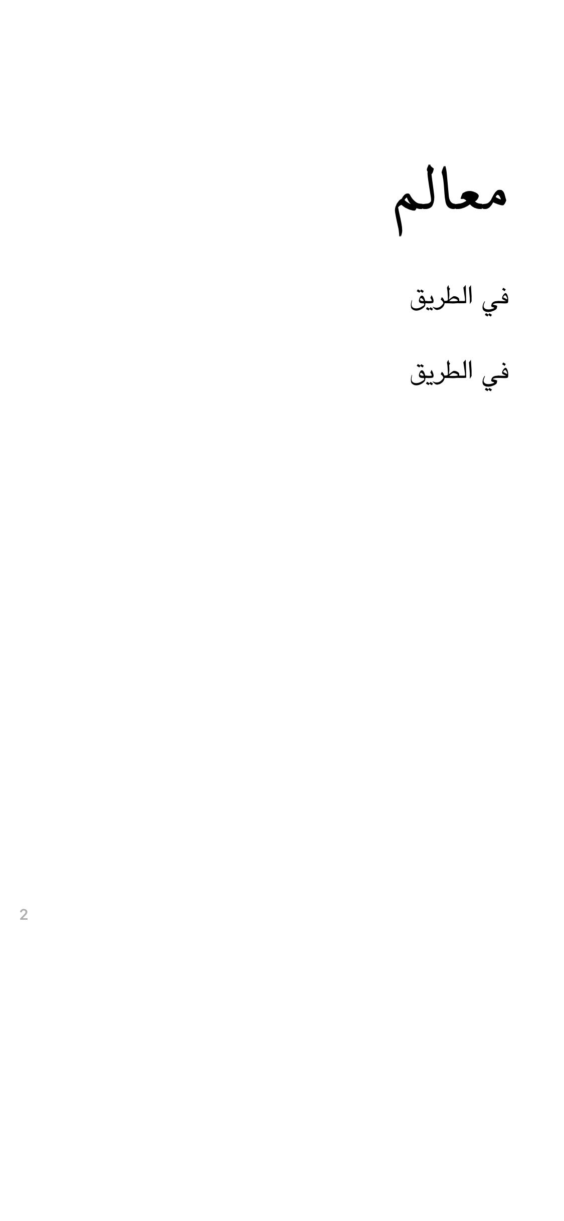

So I've been trying to figure out why the font is not working. It shows fine on Calibre but on iPhone or macOS (iBook) it is not working. Only the h1 seems to be working.
The book is 3 lines only. Could someone please take a look and advise. I am going crazy here.
I tried to delete all epubs on my Books app but it didn't help.
Thanks.

I tried it but it did not work. Also the attached file is having the same problem. As someone mentioned above, I am not using iBooks, I am using Books app that comes with macOS Big Sur and iOS 14.

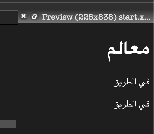

Everything seems to be working in Sigil. However, viewing them on those 2 apps does not reflect that. I attached a pic from Sigil along with what I see in Books. As you can see, for some reason, the h1 is correct and the font is used. However, for p, this is not the case.
Thank you for trying to help me!

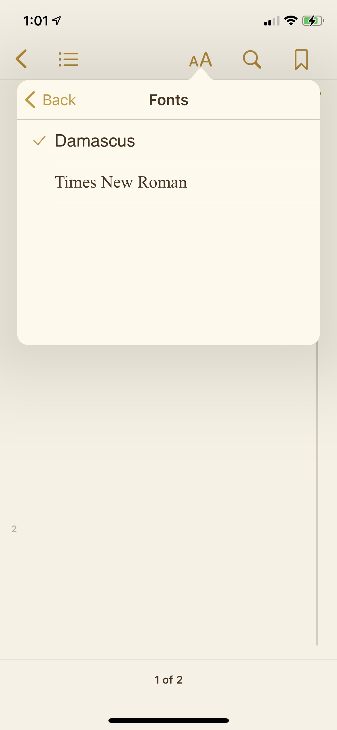

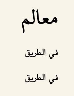

Thank you. It seems to be working on macOS Books but not on iOS Books. I attached a picture. I also noticed that some of my files which are not working has that file. However, my file is editable on Sigil. Yours is not. I have to open it with VS Code to look into it.

I have iPhone 11 Pro with iOS 14. I have no clue how you got that to work! You just download the attached file? I did that and as the screenshot shows, it did not work!
It does not even show "Original" in font selection on iOS. Also, in Sigil it does not use the font!
Are you sure you did not install the font on your machine?

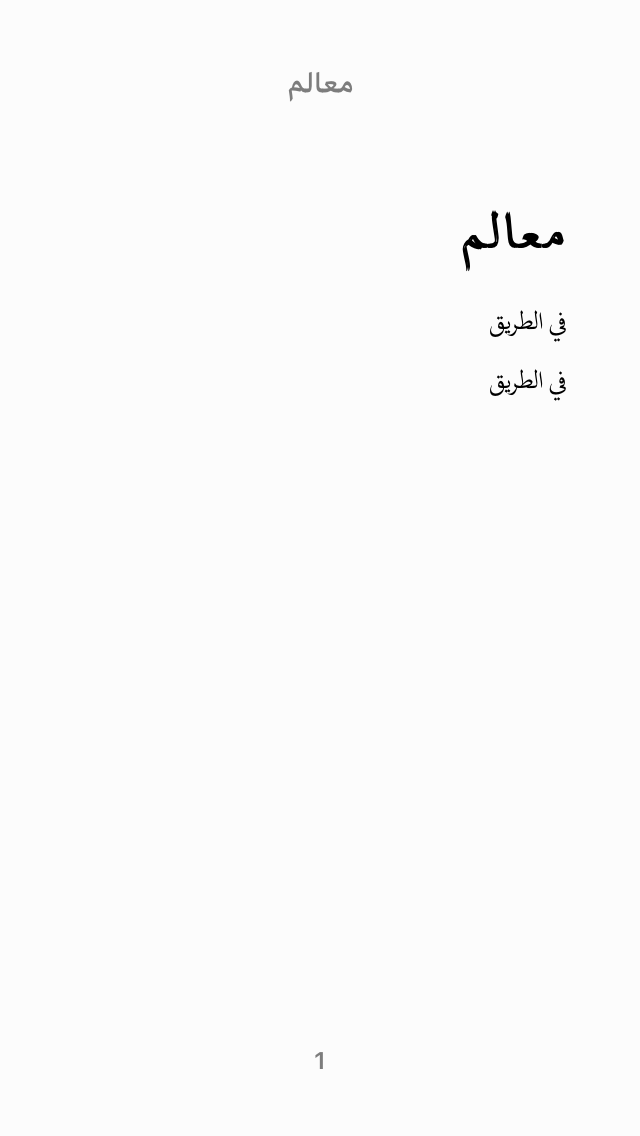

No, the screenshot was taken when I added my version of your file to Apple Books.
