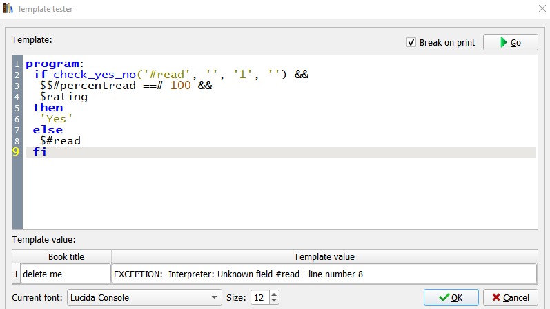

It looks like this screen capture in the template tester I am currently working on.
Edit: "Break on print" is my first stab at putting breakpoints into the template tester. If you check the box then the template is evaluated only when you click "Go" (mouse or keyboard). In this case if the template processor encounters a "print" then it pauses evaluation and opens a dialog showing you the arguments of the print and all the local variables. You can click "Go" to continue evaluating the template or "Stop" to cancel evaluation. My goal is to permit "breaks" at line numbers but I haven't yet figured out how to that.
