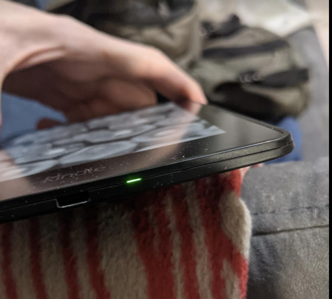

Fell through the ice while skating, Voyage green LED stuck on

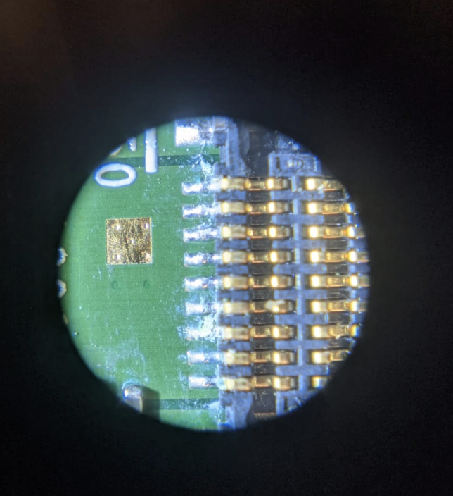

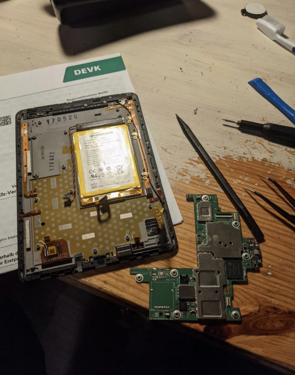

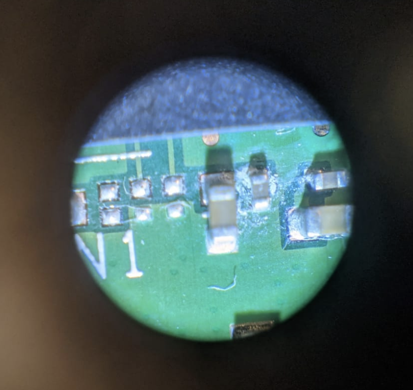

Hi all- I fell through the ice while skating along some sketchy barely frozen canals, and my Voyage got a bit damp. I took it apart and cleaned the contacts (these are pre-cleaning pics), now those spots are clean.
Is there a charging circuit / chip which I should be focussing my attention on ?
It works, but the battery level drops about 10% per day now if I don't read at all.

All important components are under the metal covers. It will be best to use an ultrasonic cleaner. There is no other way to clean it thoroughly as they are Bga chips.

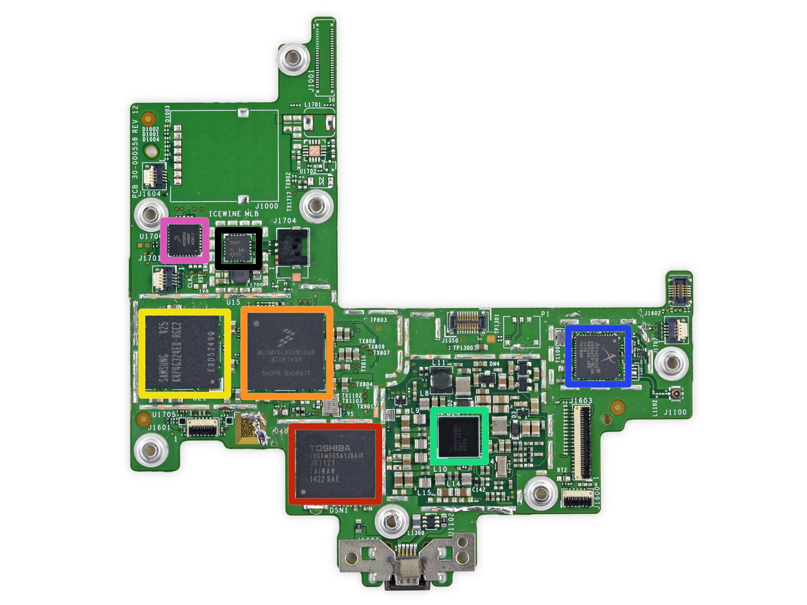

I suspect a power chip (green square in the photo). To do it right, you must at least unsolder the metal lids, otherwise the job will be pointless.
Maybe look for some gsm service that has an ultrasonic cleaner. It shouldn't be expensive.

Or repeatedly wash with IPA as it evaporates.
