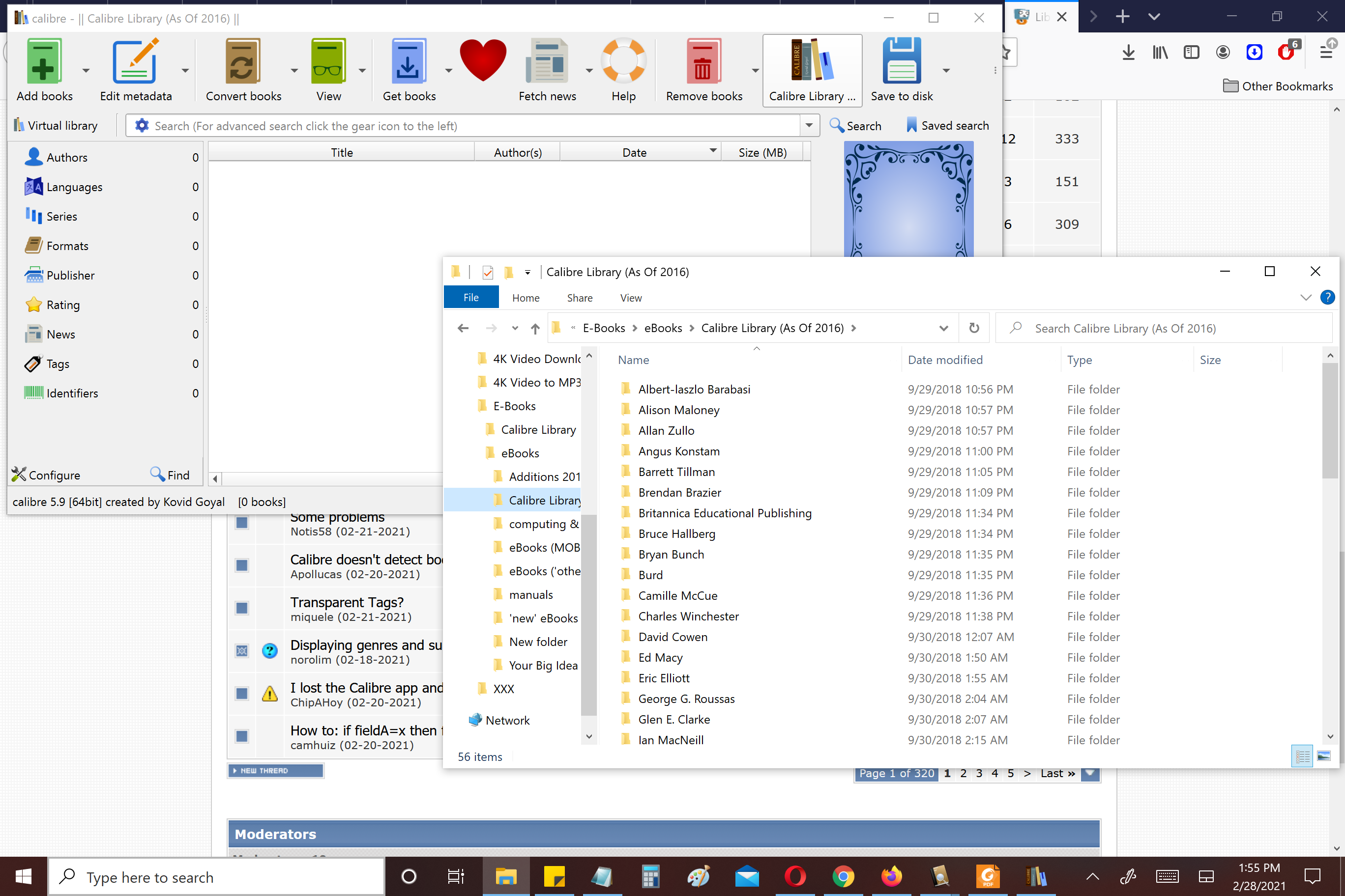

Hello, All,
Please see my screenshot, which is attached to this post.
Even though I'm clearly in the right directory, my Calibre installation just doesn't see the books that are there for some reason. Anyone know why not??
If it matters, perhaps I should note that prior to this, I'd "merged" multiple Calibre Libraries folders -- consolidated three different Caliber Library directories, to be exact, using the Move function.
No problems whatsoever merging the first two, but this third one occasioned this problem with the "invisible" books not having been moved (most have been but not these remaining titles for some reason).
Please advise; thanks!

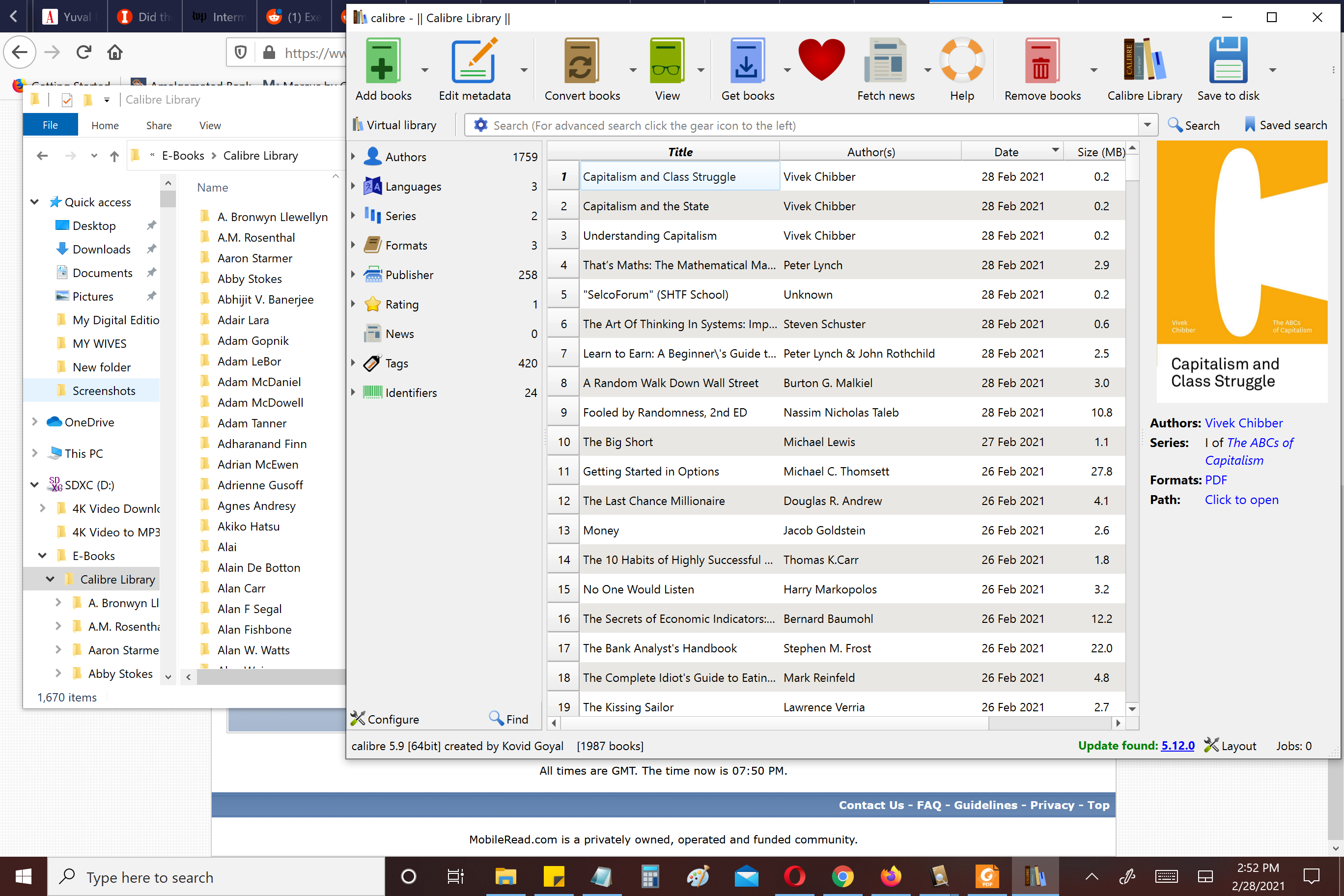

Incidentally, Windows 10 shows my merged/consolidated Calibre Library directory to have only 1,670 items in it whereas the Calibre program itself lists 1,987 eBooks here. Problem?
Seems you did it the right way. Best run the Library Maintenance (right-click on the library icon) to see what errors your library may have.

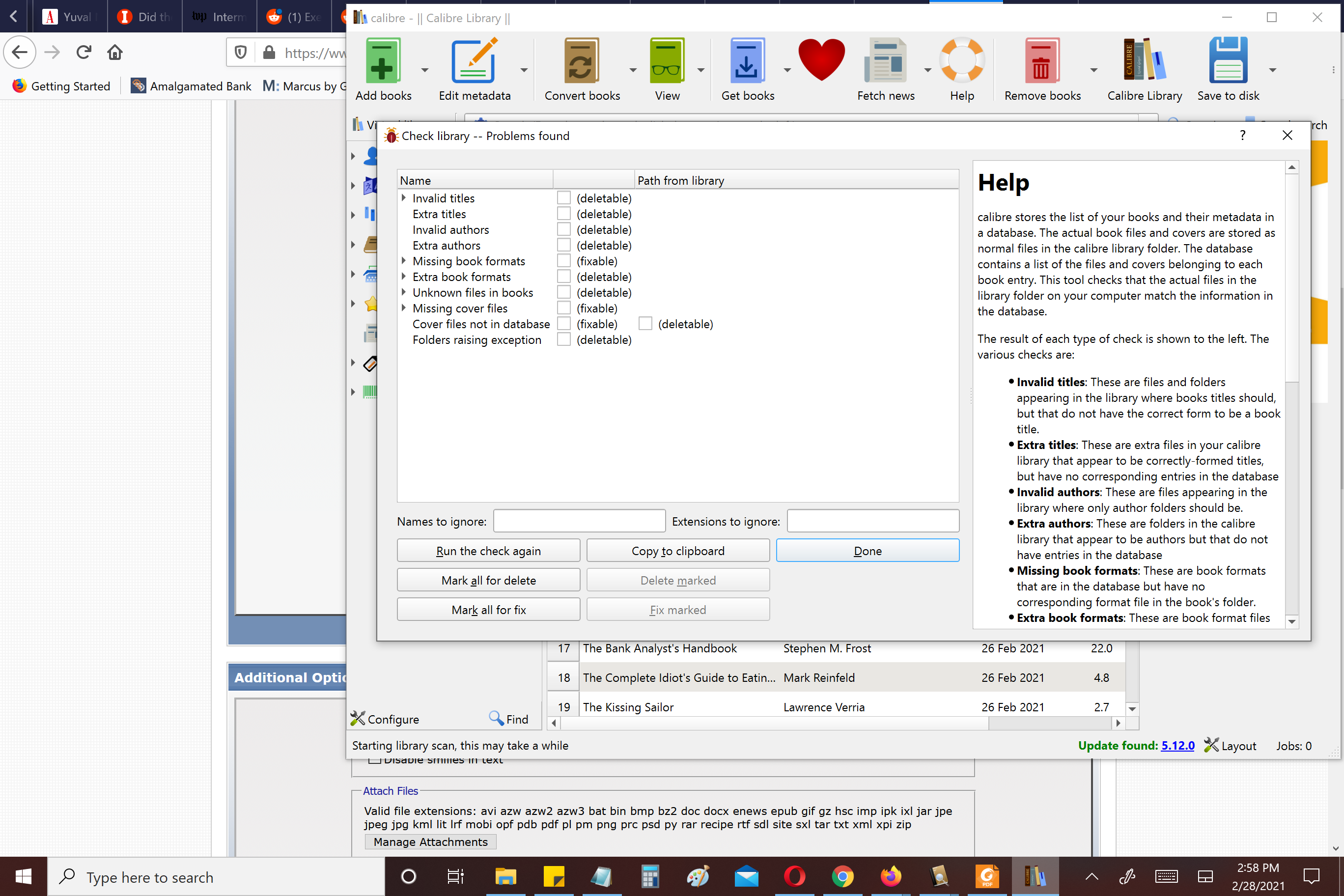

So here's a third screenshot (my second one was added as an edit while you were replying; it's about the discrepancy between the number of items my OS reports for the Calibre Library directory and what the number of eBooks Calibre itself lists for that directory).
Do you know what's going on now? I can't make any sense of it but they don't seem like serious issues.

Here's that Library Maintenance report, attached as another screenshot. Is it serious?

Seems so. Click on the tiny arrows to see in detail. And then you have to repair these errors. As for missing formats, you can re-import the formats via the edit metadata window for each such book, of course you must have a backup of the files somewhere to do that. As to extra formats, make a back-up of them first, then let the program delete them and re-import them the same way.

Hey! Just wanted to say that the problem seems resolved now; I had Library Maintenance rebuild the database and that woke up Calibre and it now sees the rest of the eBooks!

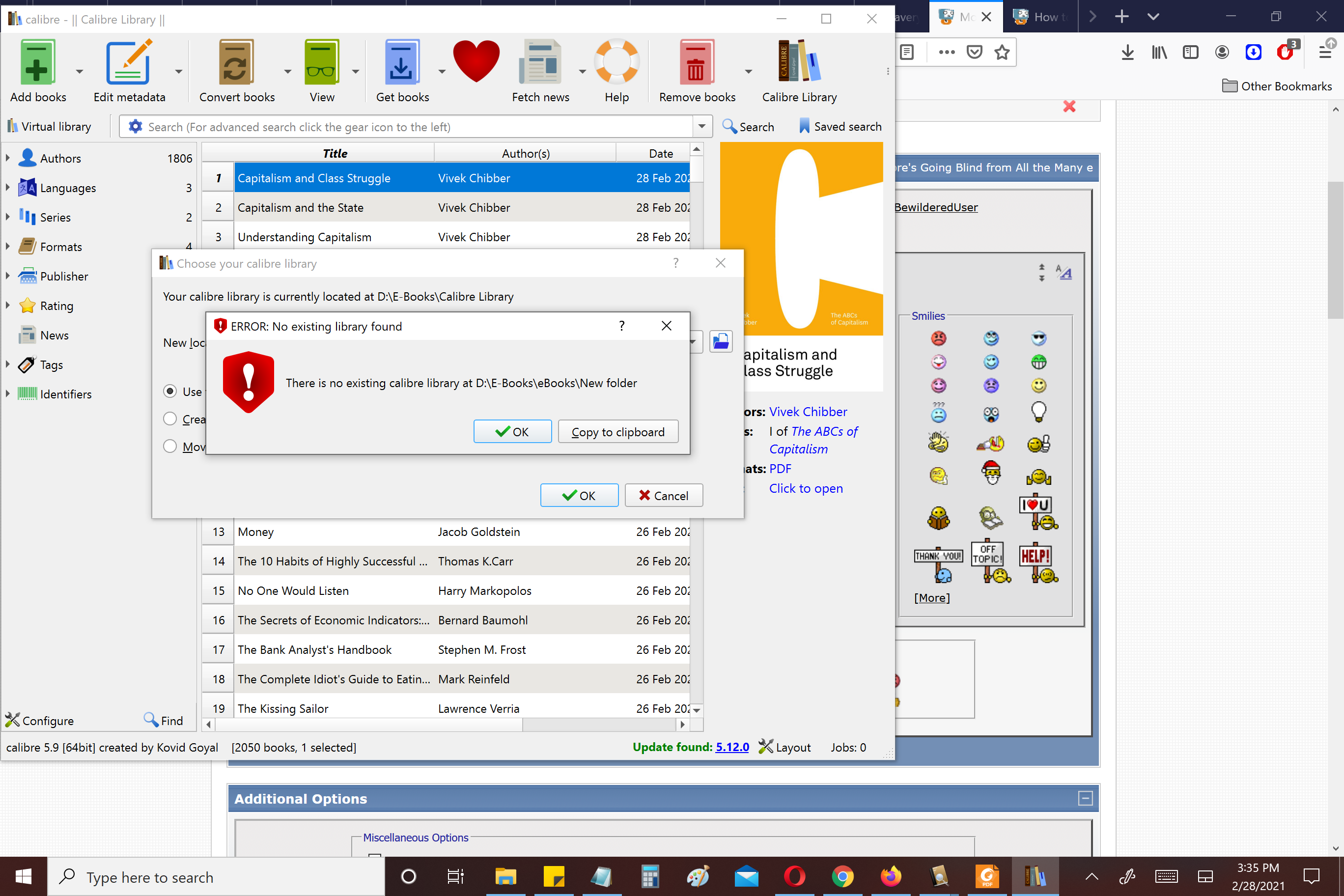

UGH -- SPOKE TOO SOON (of ocurse!).
Calibre's now not seeing other folders I'm trying to point it to (so that I can continue to "consolidate all my eBooks within the Calibre system").
Any idea why it's not seeing what's there???

Unfortunately, Calibre's again giving me problems, now not even getting into folders it knows is there!

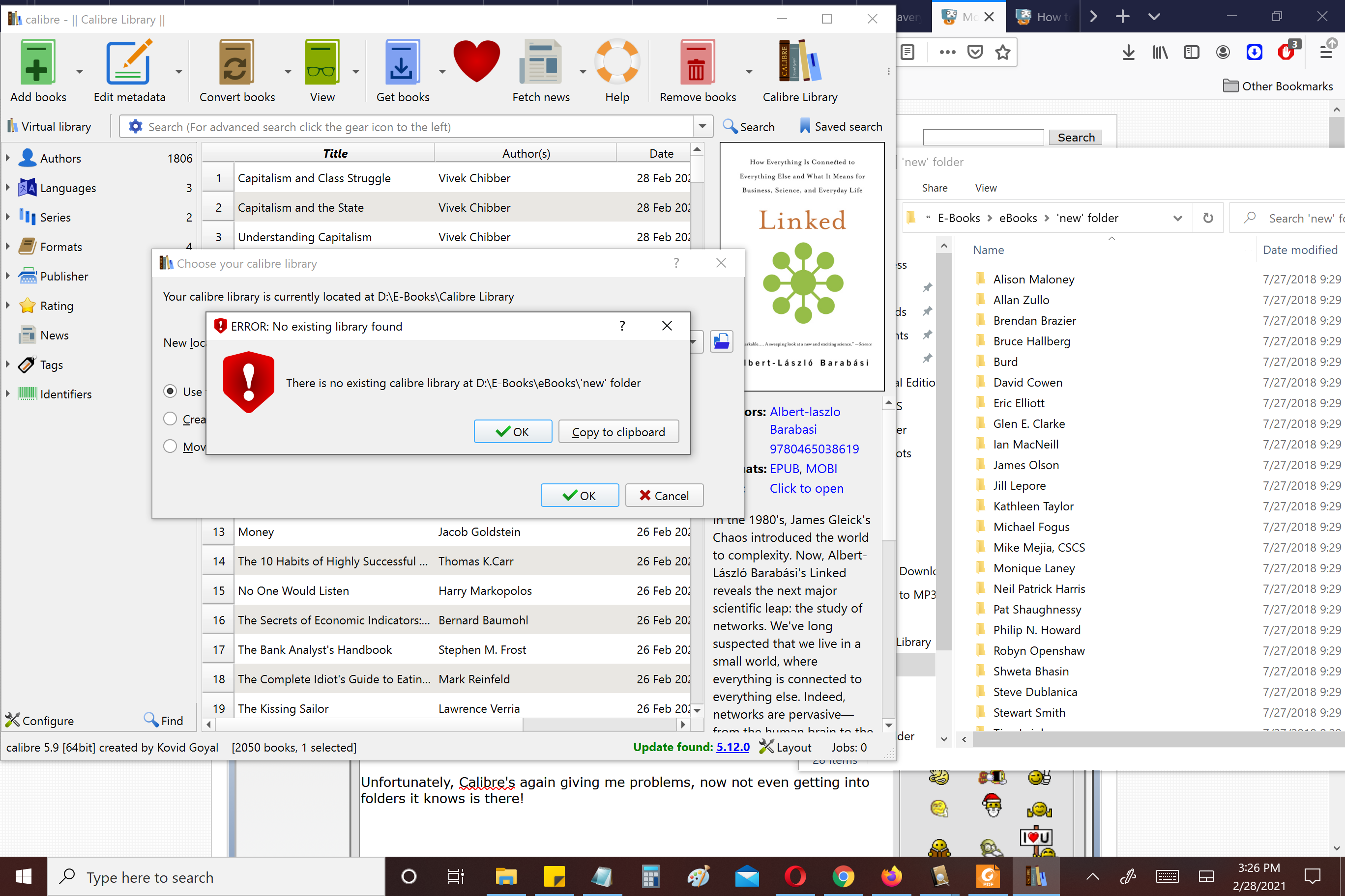

So, um, just to be clear (sorry for all my obtuse rambling): now, right now, I'm trying to "change the source" or to put it another way I'm trying to "point" Calibre's sights on to another directory. Until now, I've done that by clicking the large Calibre Library button on top but now Calibre simply keeps saying "not a Calibre Library" or "not empty folder"....

But I'm still curious...why doesn't what worked before work anymore?
Why's Calibre now telling me that any directory I try to point it at is either "not an existing calibre library" or "not empty"???
