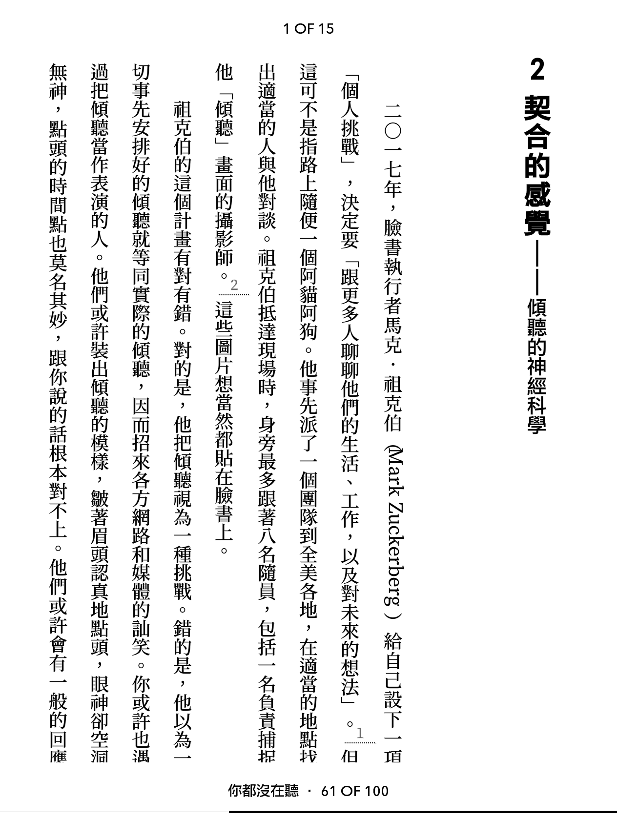

Hello,
I am experiencing a problem with side-loaded fonts on Kobo Libra H2O (4.25.15875). The text gets cut off at the bottom of the page when I am reading KePub (also ePub) in vertical layout (Chinese).

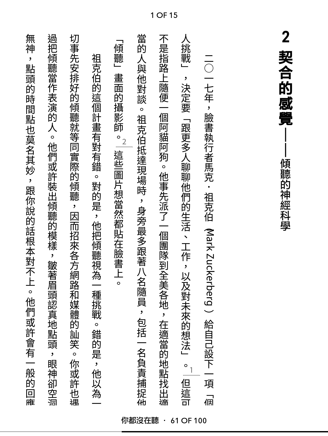

However, it does not seem to be working… (See screenshots for comparison between the default and two side-loaded fonts.)
Is there a way to fix the custom, side-loaded font being cut off issue with synchronised KePub on Kobo?
