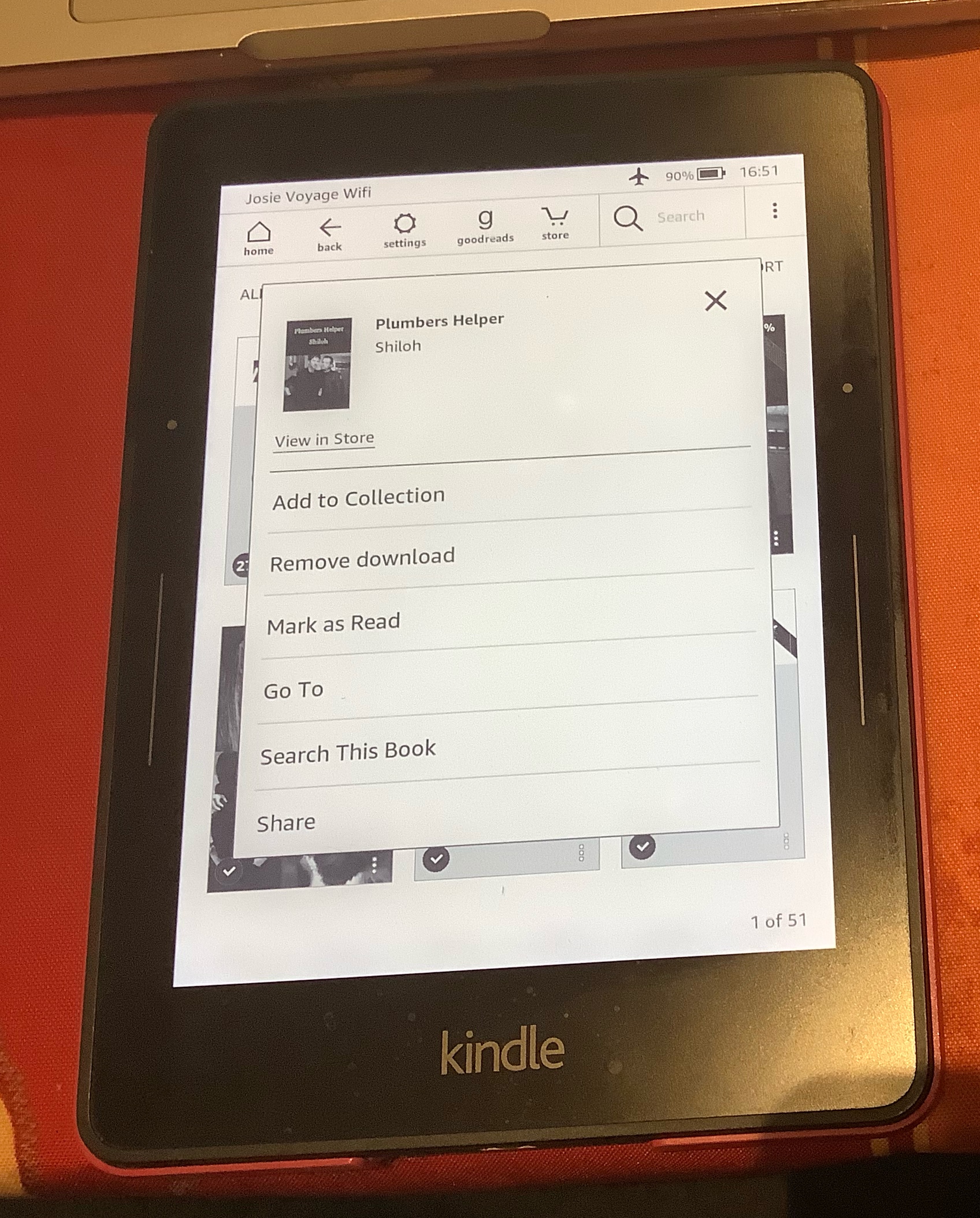

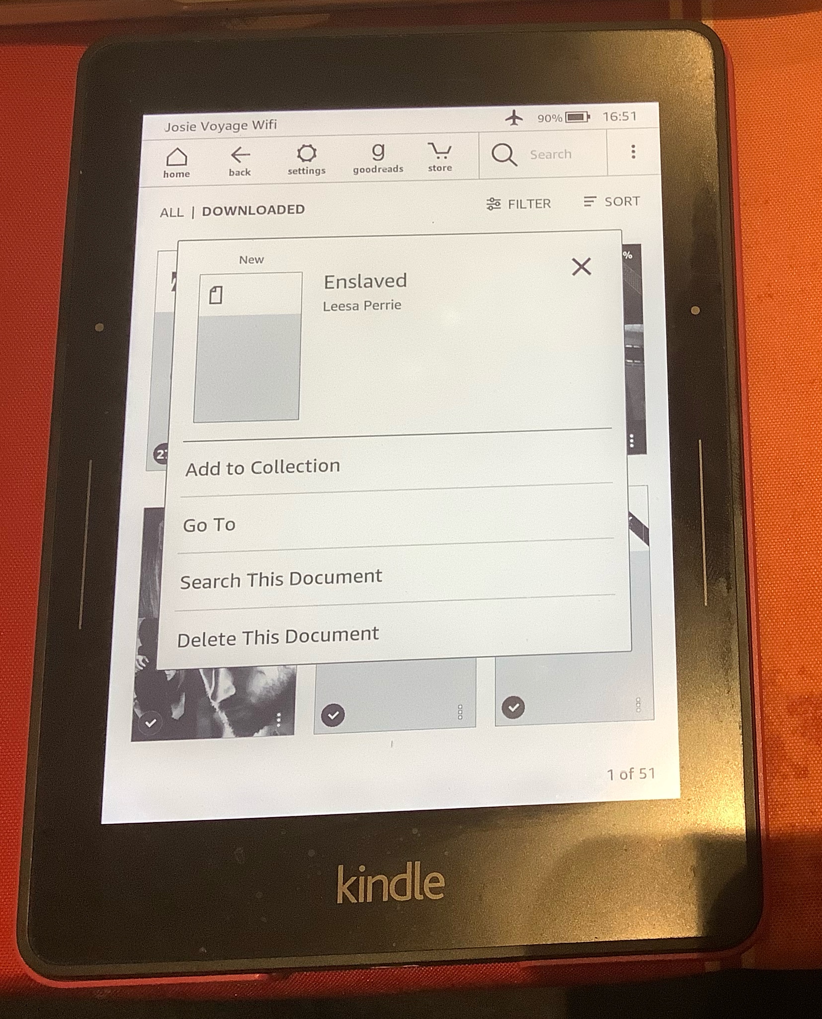

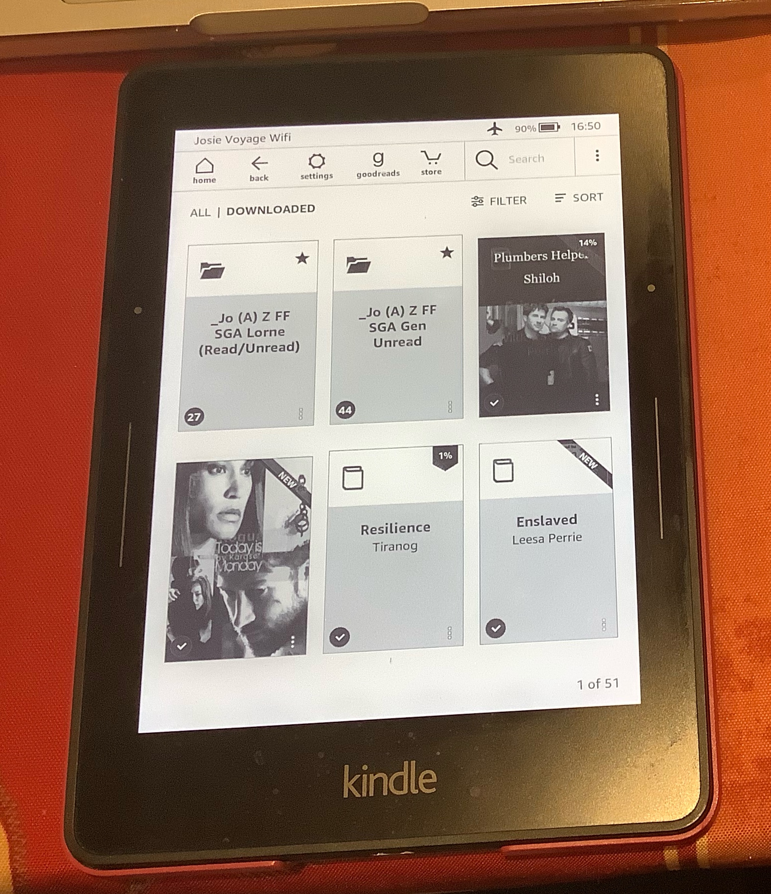

Here are some screen shots from my kindle. Different AZW3 files but the same issue.
The four ebooks shown (top two left are folders) are all identically calibre created AZW3 files. Two show correctly, with covers, and two don't. I've shown the file options as well, for one that's okay and one that's not. i hope this makes sense.

The difference between the two files is that the Atlantis book is marked internally as a regular book (CDETYPE=EBOK) while the Prison book lacks the CDETYPE metadata.
Selecting "Enable sharing of book contents..." in the "AZW3 output" section of the conversion dialog will cause the CDETYPE to be omitted. The will cause the file to be treated as a personal document and will prevent the cover thumbnail from being shown in the library view.
