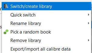

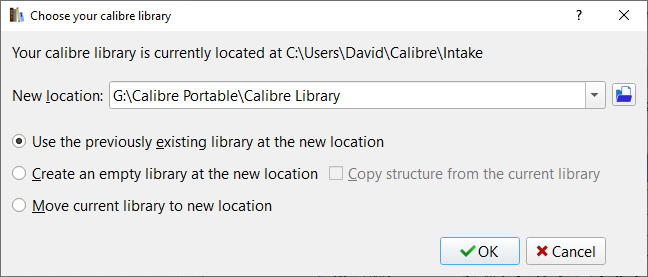

Right click the Library Icon: Create/Switch: USE EXISTING: <point to the Library folder>
Repeat for each Library

You clicked on the library icon and got the Switch/Create Library item and then browsed to the location of the old library using the folder icon at the end of the address line? See the attached images.
Is there a metadata.db file located in the old library directories?
And yes, Revo Uninstaller can be a bleeping disaster since it wants to uninstall everything associated with the install such as the data files.

The first 2 are normal Calibre (the second is just what it says: Prefs_backup)
?? the 3rd. it may be a leftover from a recovery attempt
#1 is what we said to look for.
Where that was found is the is where you 'switch to' folder.
