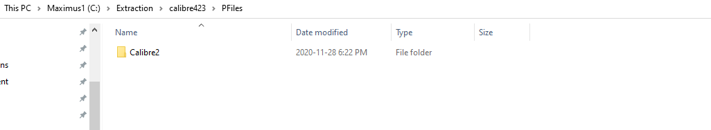

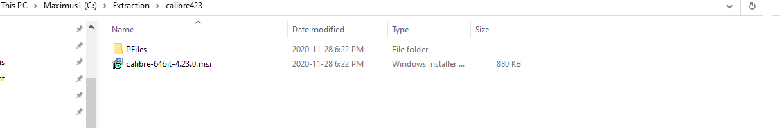

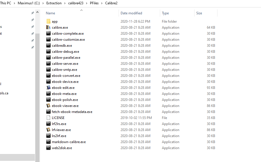

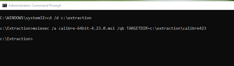

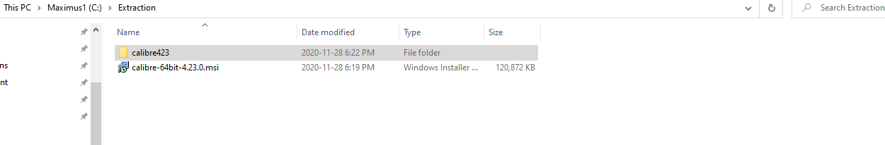

It is possible to change a Calibre Portable 32 bit install to a 64 bit install. This does require extracting files from a calibre-x64 msi and copying the calibre folder into the Calibre folder in the portable install.
Doing a step by step procedure
  • Download calibre-64bit-4.23.0.msi from calibre's download site
  • Create a directory called extraction in the root of your C: drive. Inside the directory create a directory called calibre423
  • Copy the downloaded msi file to the extraction directory
  • Open an administrator command prompt and cd /d c:\extraction
  • enter "msiexec /a calibre-64bit-4.23.0.msi /qb TARGETDIR=c:\extraction\calibre423" on the command line.
  • Checking in the calibre423 directory, you should no see a directory called PFiles with a Calibre2 directory inside it. Copy the contents of the Calibre2 directory to the Calibre directory in your portable install overwriting the existing files.
  • Run the calibre-portable.exe executable in the root of the Calibre Portable directory and you should now be running a 64 bit calibre portable install.
