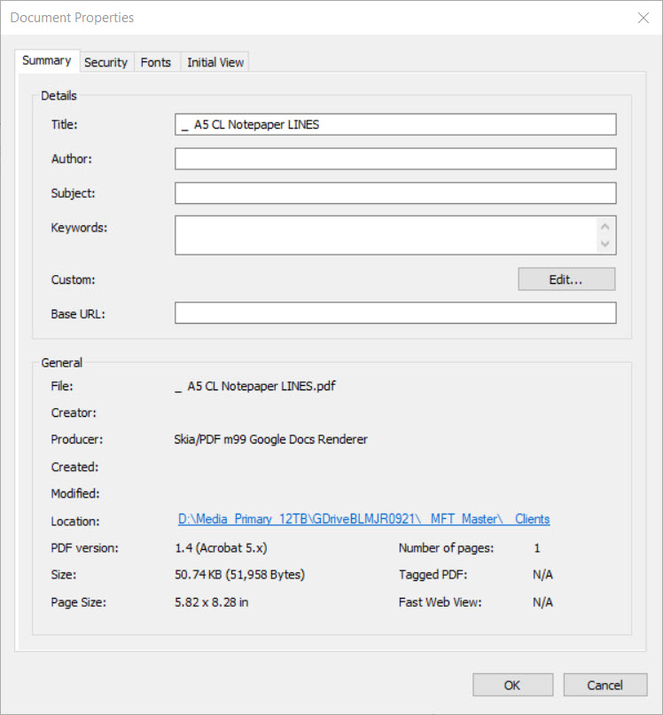

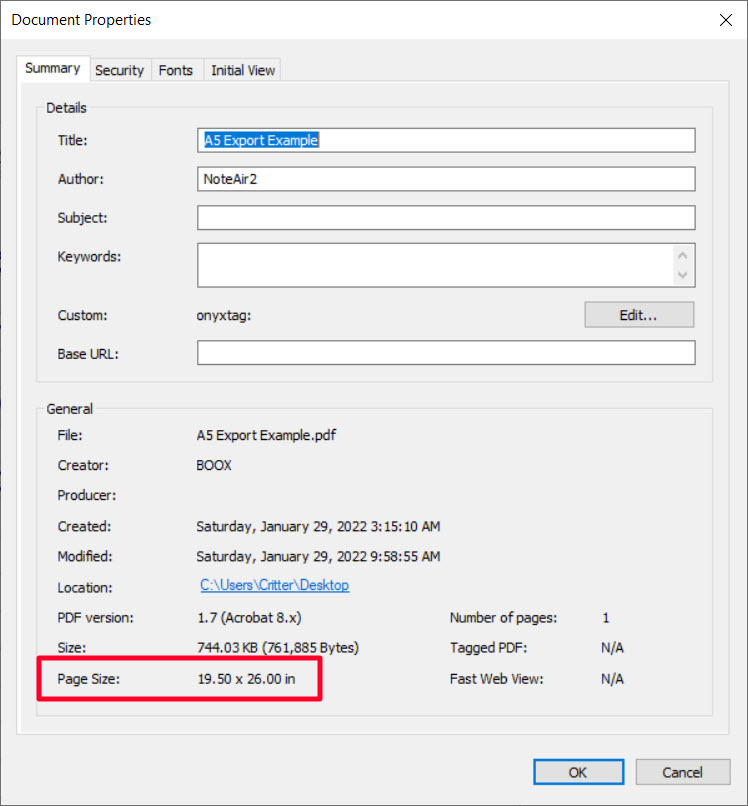

Hi Renate,
Here are some example of the original pdf, the export pdf and their properties.
Any advice would be greatly appreciated.
Have you run into this? How is your work flow?
Name:	A5 Notepaper Properties.jpg
ID:	191974   Click image for larger version
Name:	A5 Export Example Properties.jpg

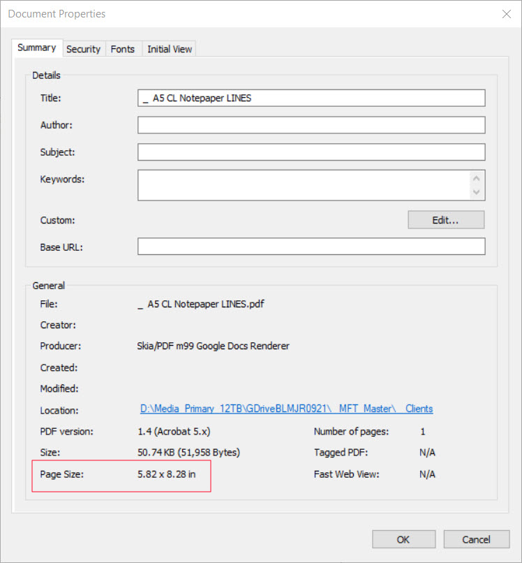

Properties Update
Here are the property sheets with the sizes outlined to highlight the size difference.
ID:	191977   Click image for larger version

Hmm, this is deep. I learned a bunch of things. Some even useful.
Ok, PDF has the "MediaBox". That tells you the number scale that everything is working on. If you say MediaBox[0 0 100 100] then PolyLine/Vertices[25 25 75 75] you'll get a diagonal line 1/2 the diagonal length of the "paper".
Ok, but what are the units? They are "points", 1/72 of an inch. Your paper is A5 (in the template). It should be (and is) MediaBox[0 0 419 596]. Your Air2 is issuing MediaBox[0 0 1404 1872]. 1404/72 = 19.5", 1872/72=26". 1404x1872 is the pixel count and Onyx is using that as paper size (in points).
So, just change the MediaBox, right? Erm, no. See attachment (which is A5 size). It's best viewed at 25% scale.
One solution: You can just use it as is, print to A5 paper using autoscaling.
You could write a utility to scale everything. Undoubtedly you can do this with Adobe "Manipulator" or whatever it's called.
The thing is, Your Air2 took your template and scaled it already. This could be fixed there in the code but it would take lots of fixing.
Best solution? Bitch to Onyx that they shouldn't be such knuckleheads as to put pixels in the MediaBox where points belong. Don't scale templates, use the MediaBox you find there.
Edit: You could fix it with "UserUnit" which changes that 1/72" to something else. If your template had a MediaBox[0 0 1404 1872] and a non-standard UserUnit to make it A5 size then this might work. Your template is PDF1.4, which doesn't support UserUnit.
Try some other template or reprocess the current template with Adobe "Manipulator" (or whatever) to see if you can put in a UserUnit.
OTOH, I just checked 94 random PDFs on my PC and none of them use UserUnit.

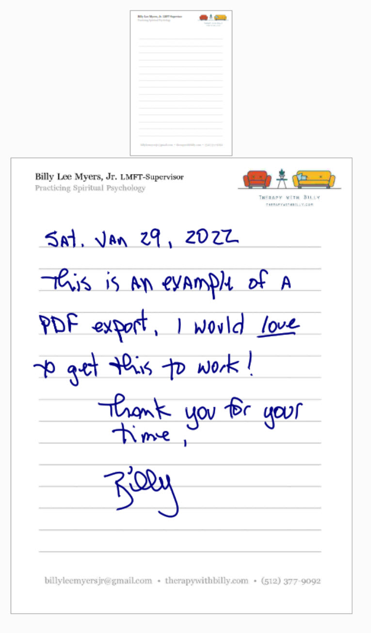

Renate, thank you for your kind reply.
I am generating the template by creating a new A5 document in Good Docs, importing my logo and typing my info into the header and footer, then just using the underline key to create the lines. Then I export that Google doc as a pdf to my desktop. From there, I loaded it onto a usb drive then copied it directly to the notes templates folder of the Boox.
All of this works like a charm and the notes I create this way on the Boox look great. I use the share button to upload to my Google Drive then import that note into my patient pdf file via Nitro Pro, a pdf editor for Windows. The only fly in the ointment: my template is A5, the size of a half page of copy paper and the notes I generate are poster size. I did try to flatten the pdf, but that only flattened the background, not the scribbles.
It is a good implementation by Onyx in that there are no jagged lines. If I were a student and I didn't need to match these notes to anything else I would just zoom far out and go about my merry way.
Yes, printing to paper with "Print to Fit" works great, but then I would need to print them out, then scan them back into my patient document.
Rube Goldberg would be proud.
Much easier to take notes on a piece of paper and scan that directly to my patient document, my current method of updating medical records.
I'm not using NeoReader for anything in this process. I've never opened it on this device, I just use Kindle reader to read books.
I don't know what "(size 105,581,292)" means nor how I would enter that in or what software I would enter that into. I don't have the training or background to tinker with the inner working of these aps, although I have deep respect to those of you who can.
Yokos - are you saying I could use a png files as the background template? I'll try that and see what happens. Is "knote" the built in note taking app on the Boox? In that case, yes that's the one I'm using.
I am a Boox newbie in case this isn't already very evident.
I see in Google Play there are many note taking apps to try. Does anyone have a favorite of those?
