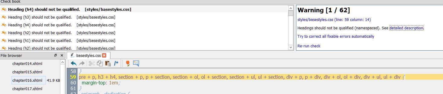

Tweaking an epub3 book for my Kindle and I get many warnings about the CSS
It still seems to format OK, but I don't see what's wrong with the CSS
I'd like to get rid of the warning messages by changing the CSS to something that the editor likes, but don't see what's 'wrong'

it will be h3 + h4, that means some h4 headings are formatted differently than other h4 headings and that's considered an antipattern by the css linting library.
