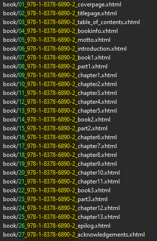

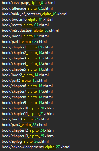

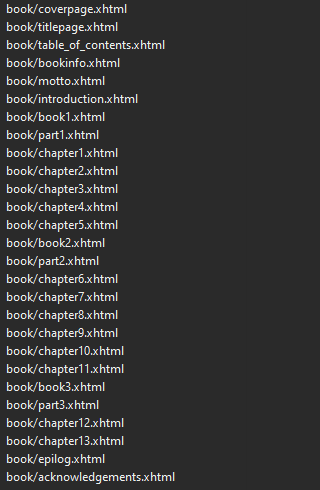

For a long time the question bothers me: can you change the file name in Sigil, and add a prefix with numbering?
Of course, I know about the possibility of adding a numbered suffix, but then the name is replaced with a new one.
With the help of the wonderful ReRename, I can add something before or after the name using regular expressions and thank you very much for this opportunity.
But my problem is different.
I would like to add some repetitive string to the existing name, plus numbering.
I will demonstrate this with the best example.
Here are the original names:
I would like to be able to add numbering (prefix):
numbering + any string + original filename
or suffix:
original filename + any string + numbering
I suspect that this option is not currently available [Sigil 1.2.0] (except for manual adding).
Is this type of rename possible to implement?
Or maybe with a plugin? That would probably be the best idea.

I tried in different ways, but automatic numbering (which I have been using for years) always deletes the original name.
So I can from such names …
  • cover.xhtml
  • titlepage.xhtml
  • copyright.xhtml
… using RegExRename to get …
  • cover-something.xhtml
  • titlepage-something.xhtml
  • copyright-something.xhtml
... but numbering will delete the original name:
  • something-01.xhtml
  • something-02.xhtml
  • something-03.xhtml
However, if there is such a possibility – I will gladly wait for answer.
