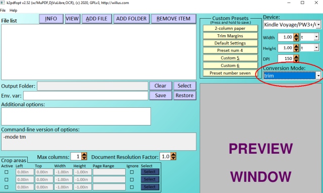

Try k2pdfopt. Maybe use "trim" conversion mode (see attached image)? Depends on exactly what you want.

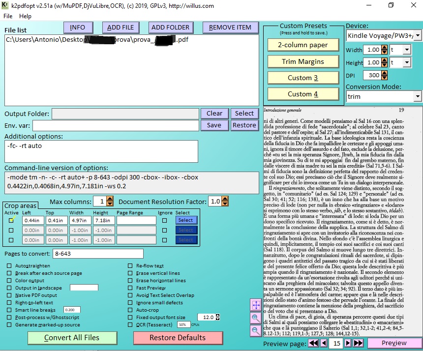

Tried, the "auto crop" option does what I needed. Unfortunatly many pages have flows inside the white margin that have been detected by the software as a limit where the cut falls. Final result: some margins are cut, others no.
But maybe I have not the necessary skill to handle well the program

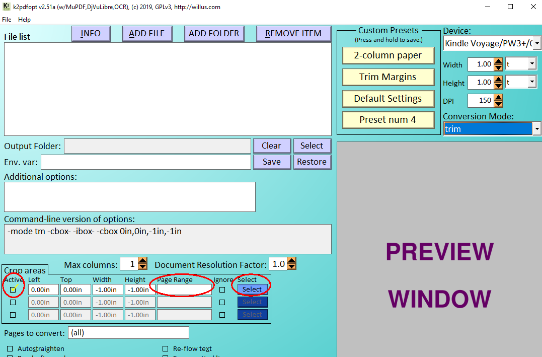

If you're using the Windows GUI, there is an area where you can graphically select a box that will trim over multiple pages. This might help you avoid having to use the "autocrop" option, which doesn't always work quite right. See the attached screen shot.
The autocrop option (-ac) also has a numerical setting which tells it how aggressive to be. You could try varying it. It depends on your document. If you could post a few sample pages that would help.

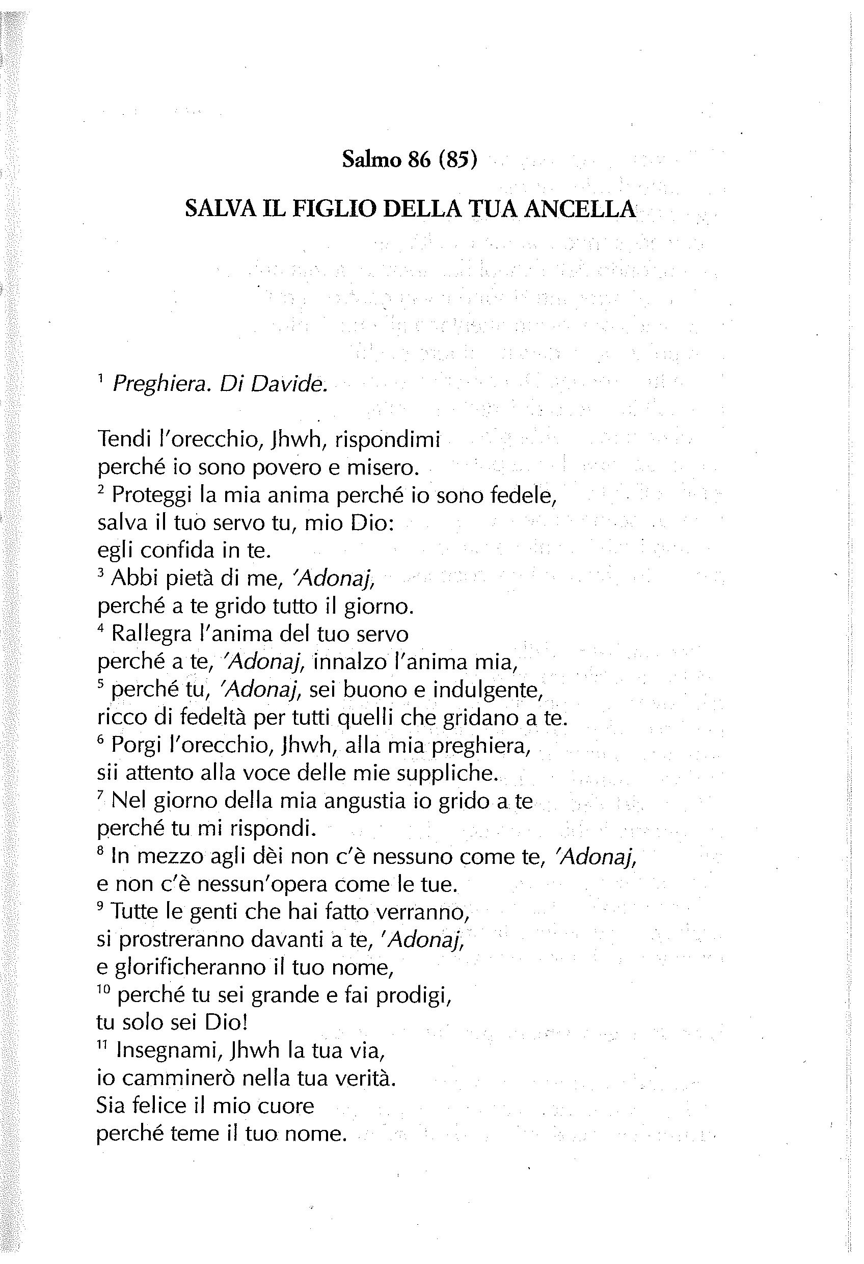

I did many tries. The file I obtained could be well but for many pages with one or more white margins kept.
The final file has a too big a size (100 MB...). See screenshot of the option I used.
Could you attach a screenshot of the GUI with the right options to enable?
PS: I'd like to get a text area only with a margin of only 2 mm around if possible.

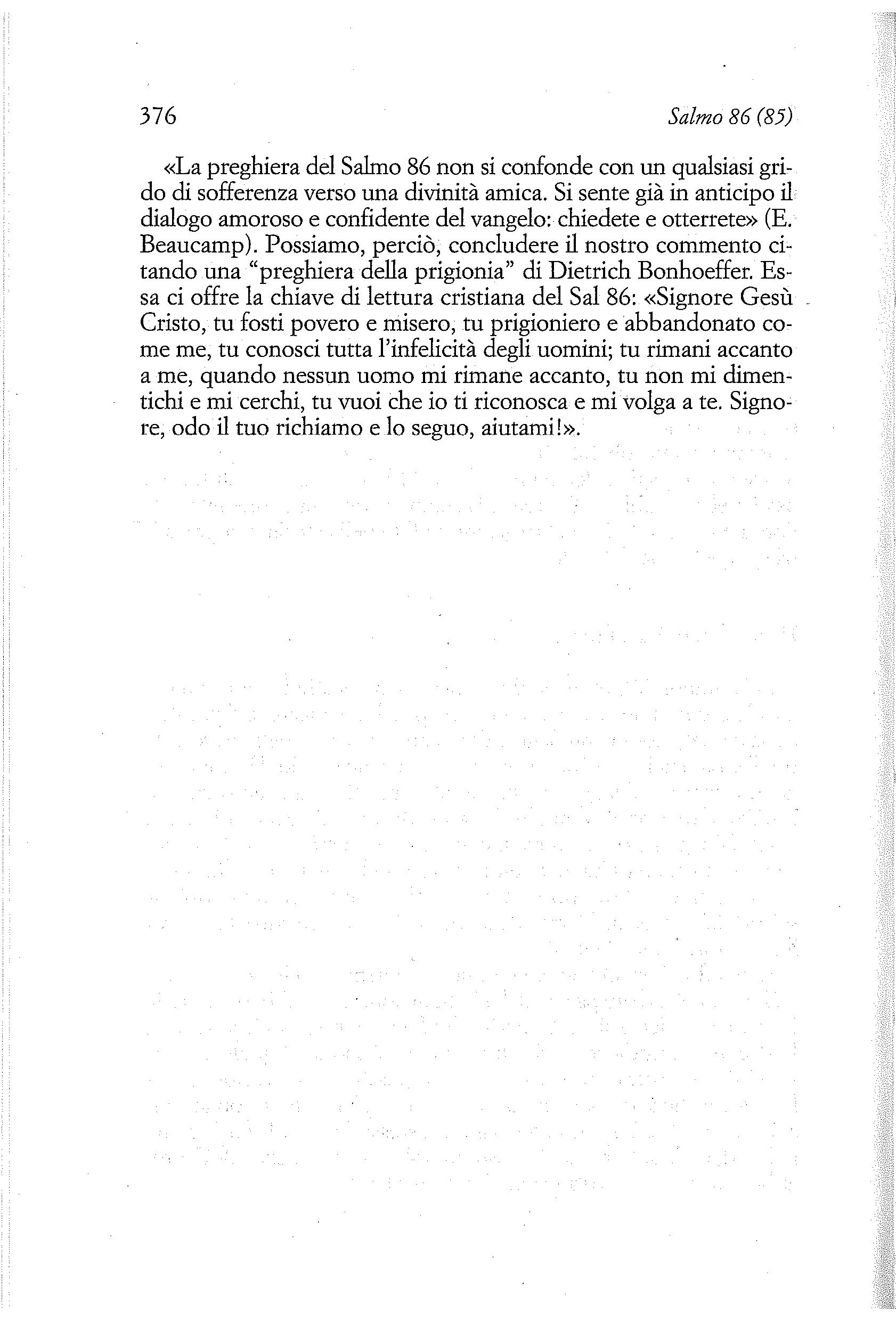

ID:	179942   Click image for larger version
Name:	imm - 0377.jpg
ID:	179943   Click image for larger version
Name:	imm - 0378.jpg
ID:	179944   Click image for larger version
Name:	imm - 0379.jpg
ID:	179945   Click image for larger version

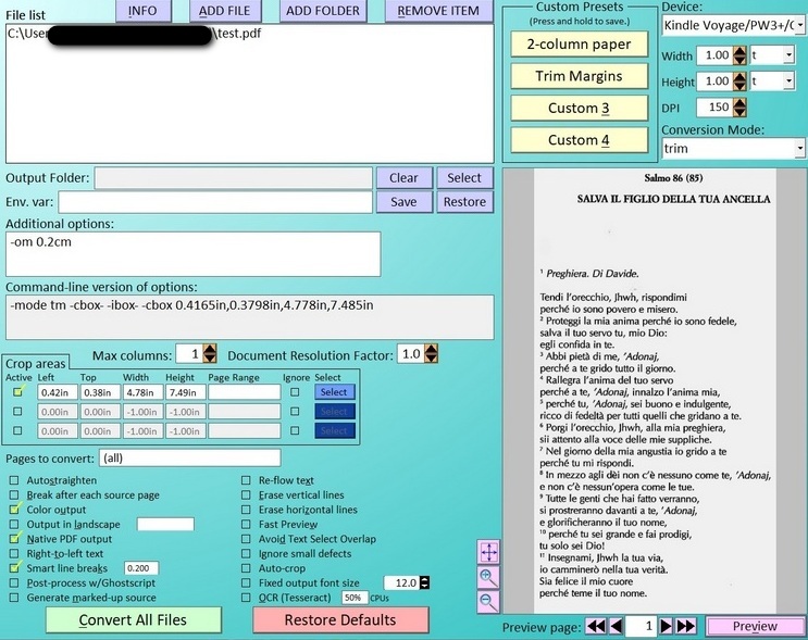

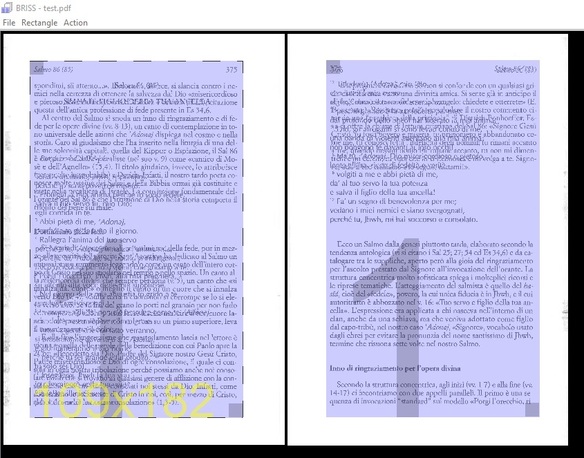

Here is your test.pdf (images were OCR-ed using Abby Finereader, but with margins left uncropped on purpose) together with two cropped pdfs, using Briss (test_cropped) and k2pdfopt (test_k2pdfopt).
It takes less than a minute (loading, cropping and saving) for both apps if we are familiar with the procedure.
In k2pdfopt we should use trim button (as you did), but together with the graphical mode (for adjusting the cropping rectangle using a mouse/trackpad) and with 0.2 cm blank margin added in the "additional option" field, as shown on the picture (the first box, in the "Crop areas" section, should be checked and the blue button "Select" to be clicked on, for the cropping window to appear).
In Briss (ver. 0.9) we have to load the pdf (using File menu, clicking on OK button when asked whether to exclude/include some pages) and then just to adjust those two blue rectangles (representing a separated & stacked odd and even pages) as close to the text as desired on all the sides, we can then use a preview capability or immediately use a "crop" command under the "Action" menu.
We can also spare ourself some time and have exactly the same size of rectangles by using copy/paste function e.g. by copying the first rectangle, after we have adjusted the first rectangle as desired.
right-click on the second rectangle (right page), and choose "delete rectangle"
right-click on the first rectangle (left page), and choose "select/deselect rectangle" and then after right-clicking on the selected rectangle choose "copy selected rectangle"
right-click on the right (empty) page, choose "paste rectangles" and then move it (position it) over the text as needed.
As k2pdfopt, Briss can also be used for an easy & quick column cropping in multi-column pdf documents or for splitting double-paged (two-page) pdf scans.
