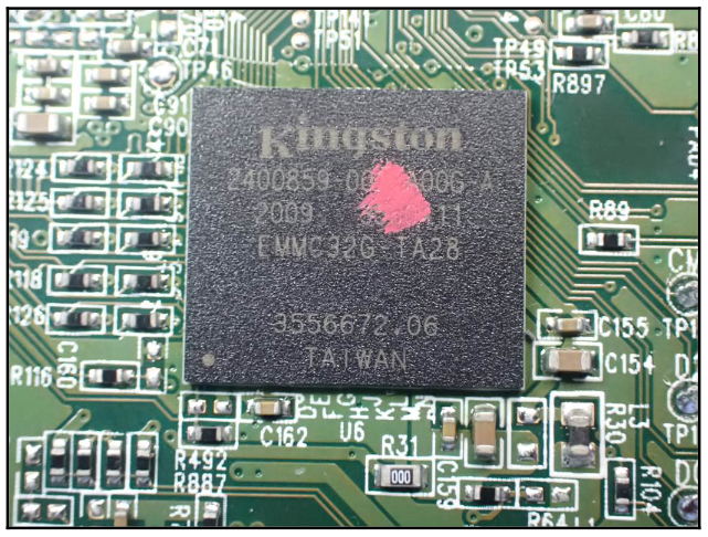

As far as I am aware which comes from an FCC document when the Elipsa was released, the Elipsa like the Sage uses a soldered eMMC chip which not removable for those of us who do not access to a surface mount rework station.
Checked and the FCC document shows the Elipsa has either a Kingston or Samsung 32GB eMMC storage device. See the attached pdf.

Some Kobo models have an internal micro SD and some use a soldered on IC. I can't see any pattern.
Original Libra uses IC, but later Libra 2 uses SD card.
Sage: IC
Elipsa: IC
Original Aura HD H2O has internal and external SD cards.
Oh well, at least it's 32 G Byte. Both reMarkable models have no external SD slot and only about 6 G Byte of user space.

I did a google search on 'Kobo N604 fcc'. A search on noikbn604 is more focused but I couldn't remember the FCC ID for the Elipsa at that time (basically, most of the Kobo ereaders show up as noikbnxxx where XXX is the digits in Kobo's model number. So noikbn605 would get you the Elipsa 2e for example.

It seems hit and miss. Of the Kobo models, I have looked at, one of the original Touch models, the original Aura, Aura One, Forma, Sage and Elipsa have fixed storage.
