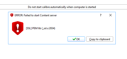

**ERROR: Failed to start Content Server
(SSL) PEM lib (_ssl.c:2834)

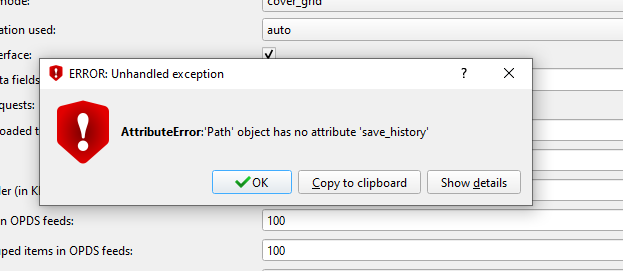

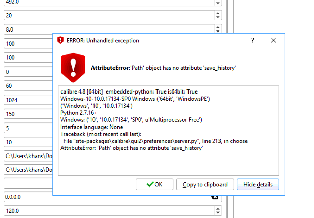

**ERROR: Unhandled exception
AttributeError: 'Path' object has no attribute 'save_history'

As I have been trying to make this work, I have tried several combinations. Whenever I try to add a file to Calibre's settings for Share over the Web, under Advanced I get an error. The error message that I get is shown in screenshot 1.
If I click OK and add the second file I get another error message when I try to restart the server, as shown in screenshot 2.

I know very little about SSL. I contacted Comodo to see if they could help me convert my certificate into PEM format. They told me that the certificate was already in PEM format. So, now I am really confused. I have tried uploading all three of the files that I received from them in the certificate box, with my private key saved as a text file in the private key box. However, this doesn't work.
I am wondering if the error message that I am receiving has anything to do with my problem. When I try to add either the certificate file, or the private key file in the Advanced Tab, I get the attached error message. If I click on OK, the error message goes away, but it still doesn't let me start the content server in SSL.

And that error is harmless (and fixed in the next calibre release) it should not affect using the certificates.
