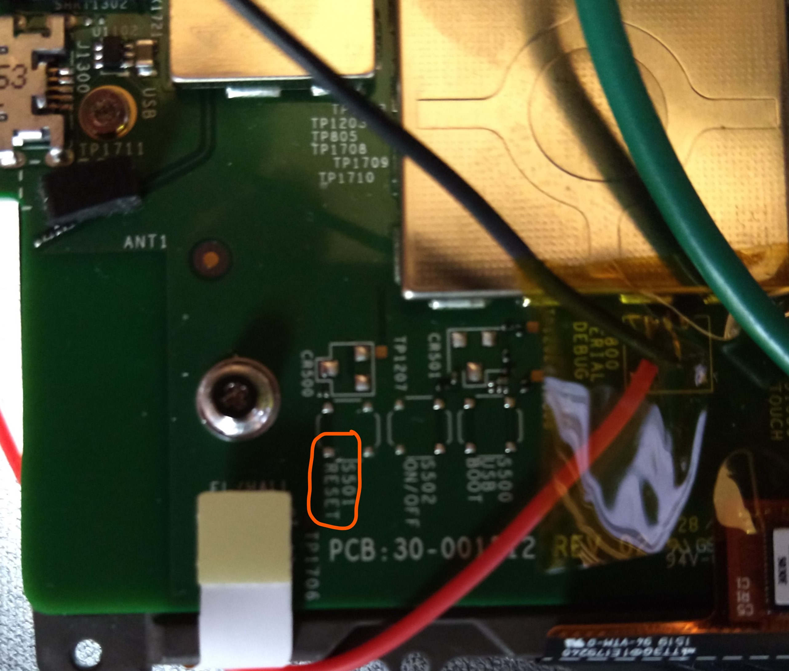

Hi Waseem, I found a pad on the PCB labelled 'RESET', and tried shorting it to some of the surrounding pins, and ground. Nothing happened when I did this. Can you be more specific about what I should connect it to? see the picture
Attachment 177195
thanks!
Try livening it with voltage from the reference battery voltage point (the one labeled TP1207).

I got the hard reboot to work by doing what Waseem suggested (briefly connecting it to TP1207). However, it responds the exact same way as holding down the reset button. And still hangs at the Tree Screen.
Are there any other suggestions?
