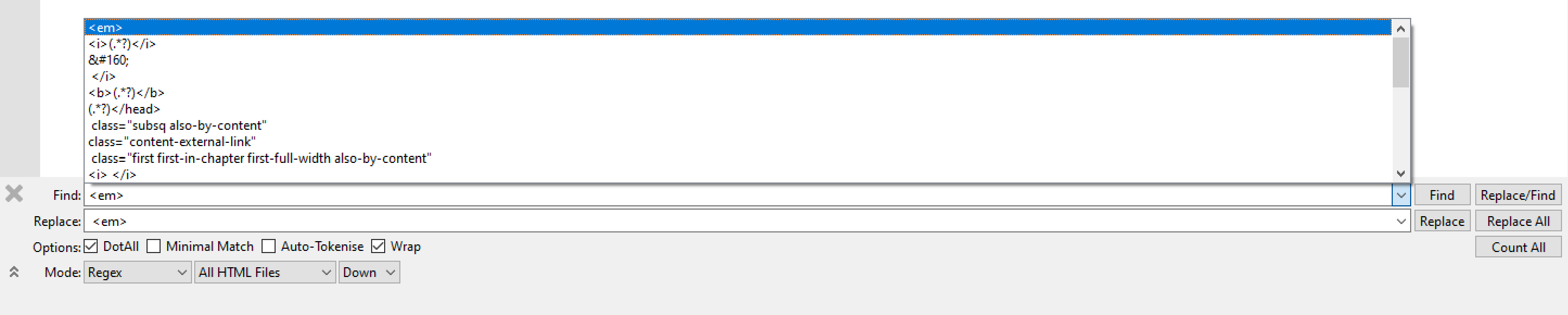

Hi, all,
I am using Sigil on Linux, Ubuntu 18.04 LTS.
Since version 0.9.18 I am compiling Sigil by myself, running all right, almost without problems. Now I compiled and installed v. 1.1.0.
The one problem I encountered is with "Find-Replace" - Sigil used to show previous searches, but not anymore. When I start Sigil, no previous searches are there in the drop down input field. That happens in the three last versions, 0.9.18, 1.0.0 and 1.1.0.
Any ideas?

Hmmm....seems to work ok on Windows10.

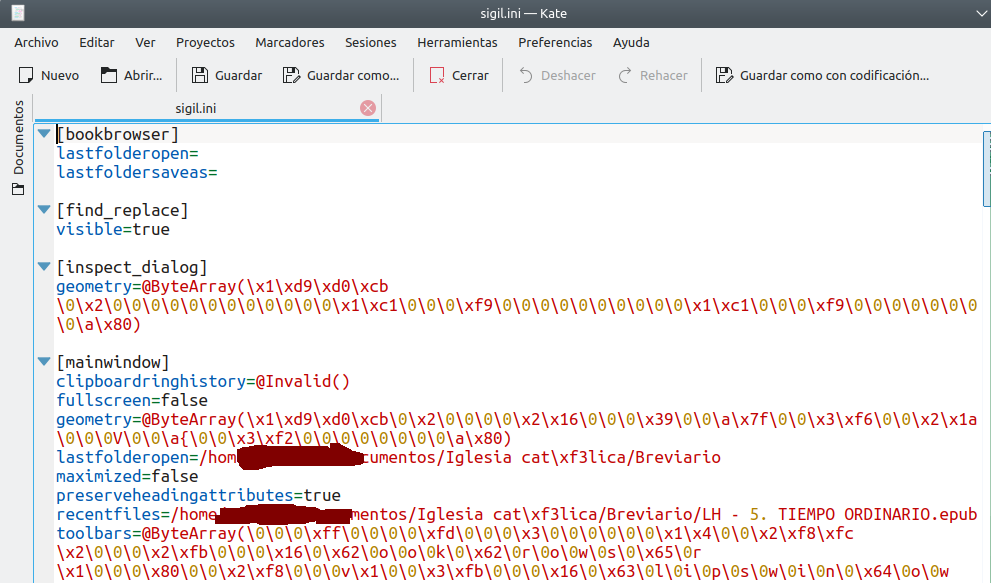

I had tried working with a new sigil.ini, with the same result.
Now I erased all .ini files, to start Sigil from scratch. Still the same problem. sigil.ini gets generated all right, saves other stuff (see attached: lastfolderopen and recentfiles), but not the searches. When I restart Sigil, again find replace is empty.
BTW, my Qt5 version is 5.9.5+dfsg-0ubuntu2.4

That's certainly weird. It's not saving ANY F&R settings (other than whether F&R is open or not).
Should be stuff like:
look_where=0
search_direction=0
regexoptiondotall=false
regexoptionminimalmatch=false
regexoptionautotokenise=false
optionwrap=true

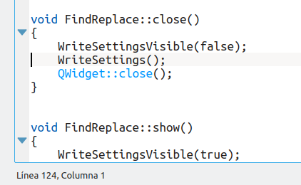

I think this means that the FindReplace Destructor is not being called for some reason by this version of Qt.
Please try the following for me:
1. edit Sigil/src/MailUI/FindReplace.cpp
2. copy line 80 (call to WriteSettings)
3. paste it just before line 124(just before QWidget::close().
Then run make again and test things.
If that helps, then the FindReplace destructor call is never getting evoked or is invoked too late for some reason.
Please let us know if that helps...
I did so, reinstalled with the new FindReplace.cpp, no change in Sigil behaviour ...
Does it build up a search/replace history as long as Sigil stays open?
Yes, it does.
