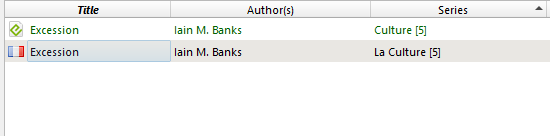

The aesthetic solution instead having a column with 99% English, is to have flag for other languages:

The flag idea is nice: Preferences:Look and Feel: Column Icons (a tab)
would be one way to implement it without having the Languages column actually showing itself
