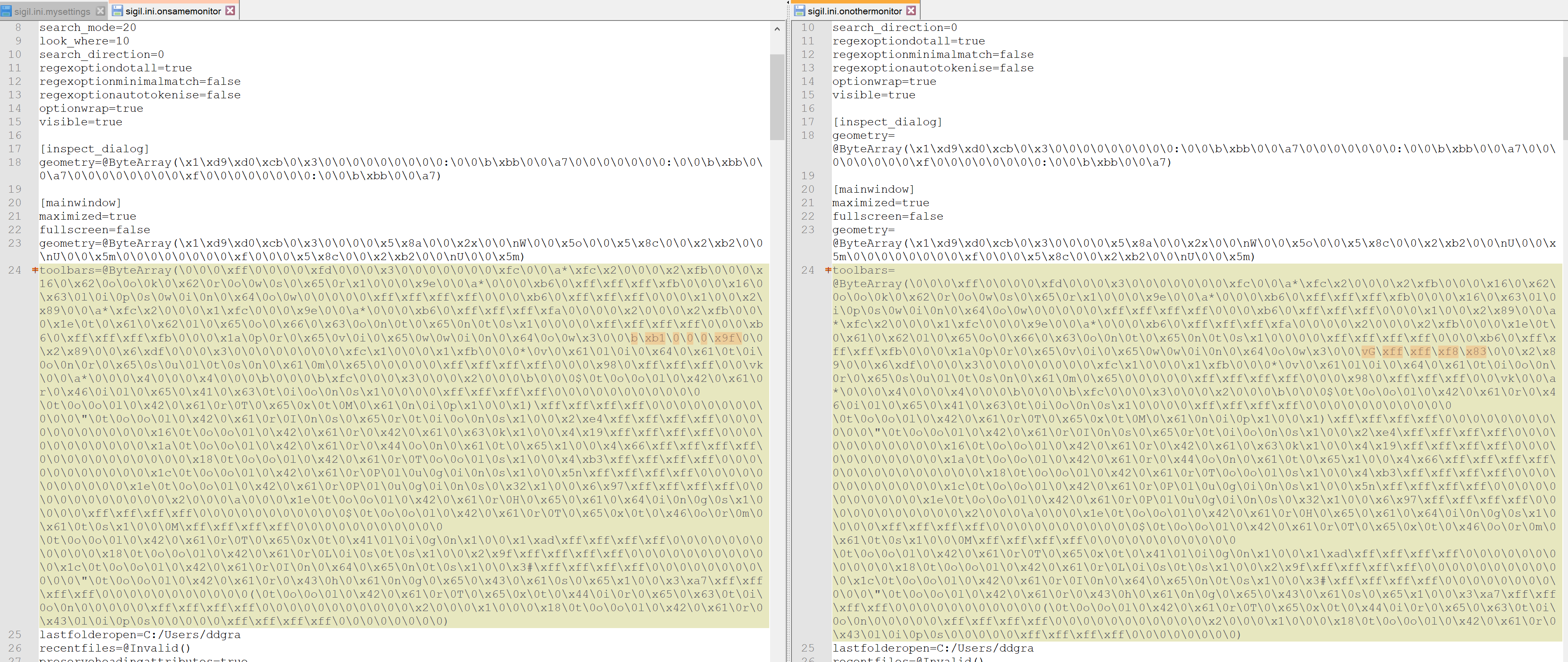

I got a new monitor - yay Christmas! - and thought I'd see if Sigil (v1.0.0) still had it's second monitor crashing issue....and yes, it does.
Both monitors are the same model (3840x2160) running on Windows 10 (latest version). I have the desktop extended in the vertical direction - secondary monitor above primary. Although, the crash still occurs whether its extended vertically or horizontally; and it crashes even when I reduce the resolution on both monitors down to 1024x768 (talk about unnatural! ).
The problem happens when I try and instantiate the undocked Preview Pane (PP) on the secondary monitor. This can be done either by:
1 - having Sigil main window on the secondary monitor and then double clicking the PP to undock it
or
2 - closing Sigil with the PP undocked on the secondary monitor - the next time I run Sigil the PP tries to reopen on the secondary monitor
It's important to note that undocking the PP on the primary monitor then moving it to the secondary works just fine - it only crashes when the PP is initialized on the secondary.
Once Sigil crashes the work-around is to delete (or rename) the Sigil.ini file and then Sigil opens with the PP re-docked. However - I went back and did some testing with the .ini file. I copied pieces of the original .ini into the newly generated .ini and tested by opening Sigil. It opened just fine every time. ie, It eventually opened just fine with all the original .ini information.
I've attached my .ini files (created after closing with PP undocked on the primary monitor - which works fine, and another one after closing with PP undocked on the secondary monitor - which crashes) in case that helps. I've also attached an image with the two files compared showing the small changes in the "[mainwindow] toolbars" section.
FYI - I also left the Saved Searches and the Special Character windows open on the secondary monitor when I closed Sigil. Those windows were closed when Sigil restarted, as they should be, so I think this is specific to the PP.
Does anyone have an idea? Is there an .ini setting that tells Sigil to have the PP docked on open??

From your ini file it shows that in both cases the Sigil app is Maximized.
Does this crash happen if you do not have Sigil maximized?
KevinH

Yes, it does.
I will test this out on a couple of other computers tomorrow to confirm the issue. Although it would be weird since I've gone through several upgrades - including completely fresh installs - on this computer. I think I posited the idea that having QT/python installed may have corrupted this machine, but was told that it doesn't.

The problem may be related to this Qt Bug:
https://bugreports.qt.io/browse/QTBUG-77385
It seems when a floating Window is restored, it should only appear on its main monitor, but the code in question does not do that for some configurations of displays and the floating window is either unaccessible or possibly crash?

Yes that is the one. We can apply Kovid's fix in MainWindow. We use both restoreGeometry and restoreState and the workaround provided in that Qt issue did as well but only the restoreGeometry call need be fixed.
I now have a new external monitor from Santa as well, so I should be able to test this as the lost floating qdockwidget is an issue on macOS as well.
I take a peak at it tomorrow.

So, I tried two other computers in my house - both Windows 10 - and neither of them showed this problem Neither of them had Sigil installed before, it was a fresh install of 1.0.0 and it worked as advertised.
I went into my computer and removed QT, and python 3.7 - restarted the computer and Sigil crashes.
The QTBUG-77385 you referenced does sound similar-ish. Hopefully it works - I don't relish wiping the hard drive and doing a fresh install!
