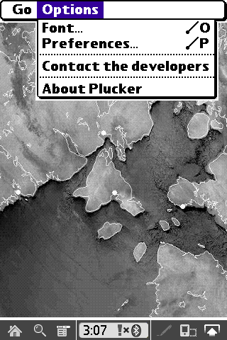

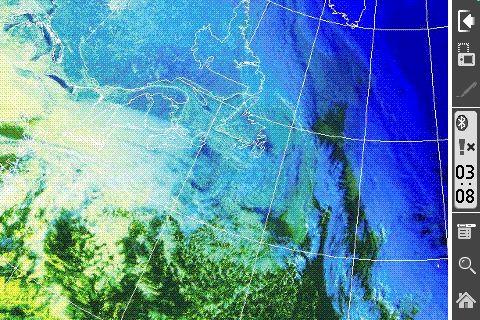

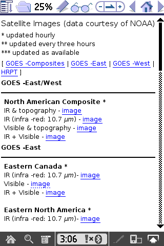

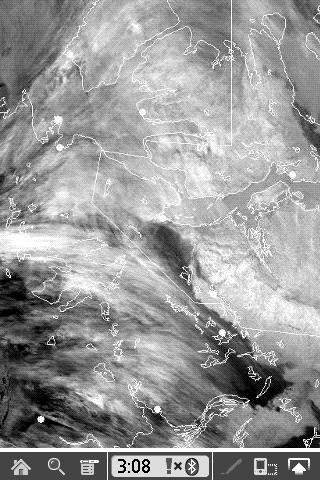

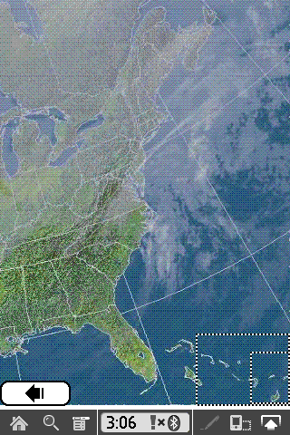

Originally Posted by hacker
I may make these .pdb files public soon.
Incidentally, these .pdb files that I create are roughly 23M in size. Not exactly small, but they are VERY packed with images.
Check out the screenshots below for some examples.
