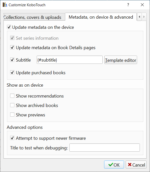

I would suggest checking the Attempt to support newer firmware checkbox in the KoboTouch/KoboTouch Extended driver settings. See the Metadata, on device & advanced tab for the setting. I've attached an image of the setting as well. This should deal with the database version issue.
Your communication issue is possibly a database corruption issue. If you have the KoboUtilities plugin installed, use it to check the database. If you don't, install it. If it shows database integrity issues, I'd suggest signing out of your Kobo account and then signing back to correct the issue.
As for saving highlights and notes, there I can't offer much help. I've used the Annotation plugin a couple of times to retrieve annotations from a Kobo but since the majority of my usage is to mark errors for correction, I've never worried about restoring annotations to a Kobo and am not sure if there a way to easily do this.
Hi DNSB,
I can try the "Attempt to support newer firmware" later.
Even prior to my original post, I have already tried signout/signin. It went through the process of rebuilding the database, but - as I mentioned in original post - it did not fix it and in fact, I believe it messed it up even more.

Anyway, I just tried the "attempt to support..." and it fixed everything EXCEPT the weird book names I mentioned earlier (appbar.align.auto, etc). These are png files that show up my book list. I recall now that I recently experimented with koreader - could this be what is causing these png files to show up as book names?
