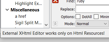

@KevinH thanks for the process, I think I better understand it now. Although the double click on ".opf" yields a message at the bottom "External Xhtml viewer works only on html resources"

How old a version of Sigil and PageEdit are you using? PageEdit and Sigil added support for loading via the OPF file a few versions back.
Also, contrary to what Patrik wrote, PageEdit always reads and writes directly to files. It is Sigil that caches file contents internally that makes it appear as if changes in Sigil do not appear in PageEdit after PageEdit is launched.

@KevinH indeed, using the portableapp version, I was kept backward... just updated, and it works fine.
