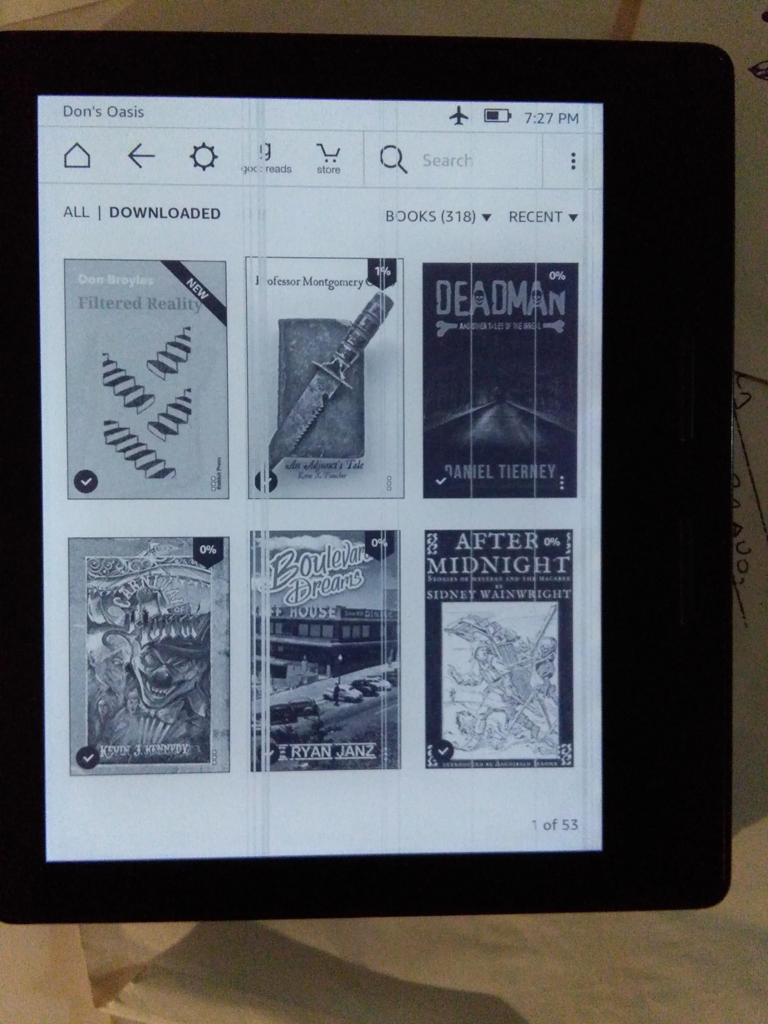

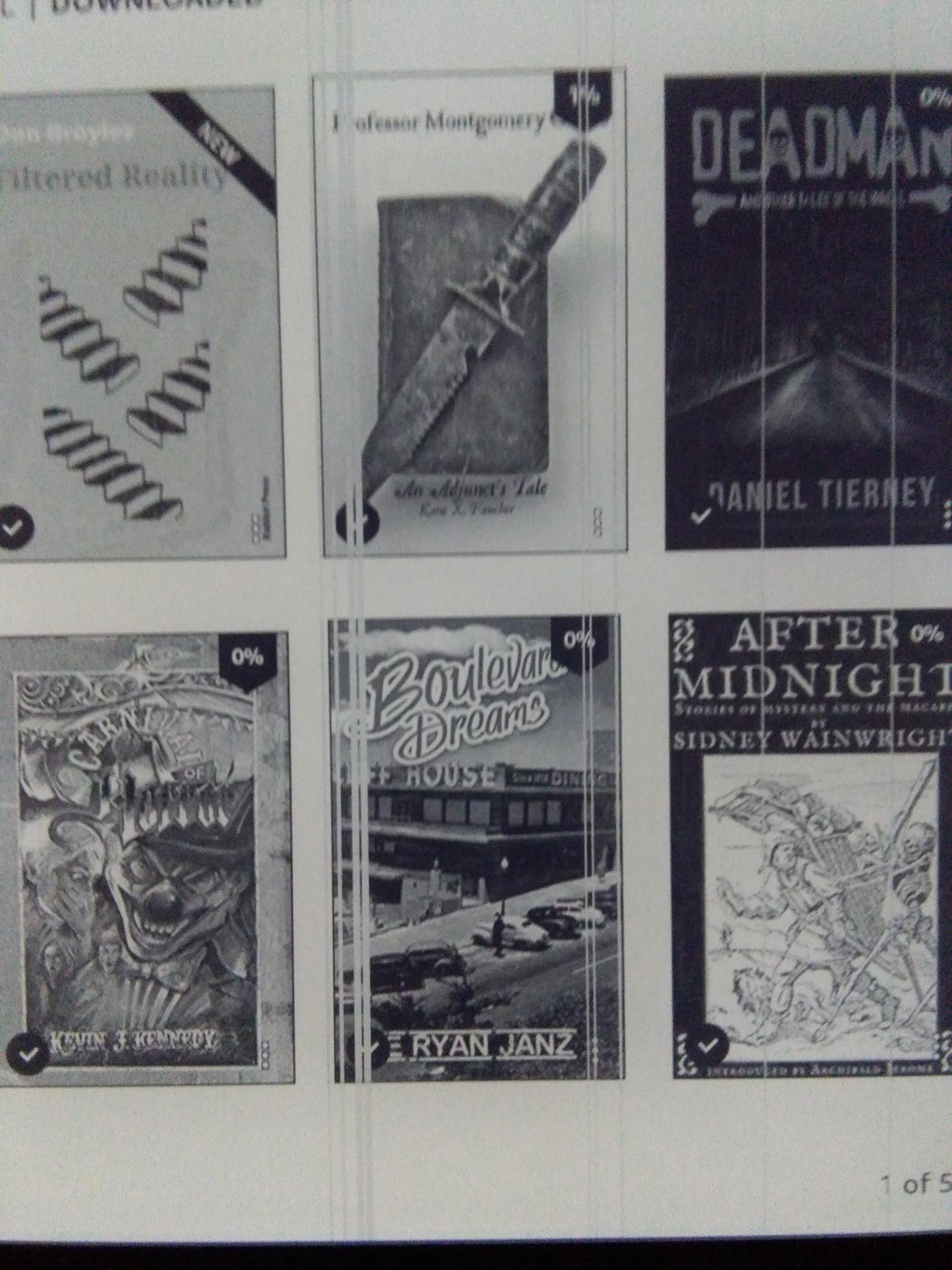

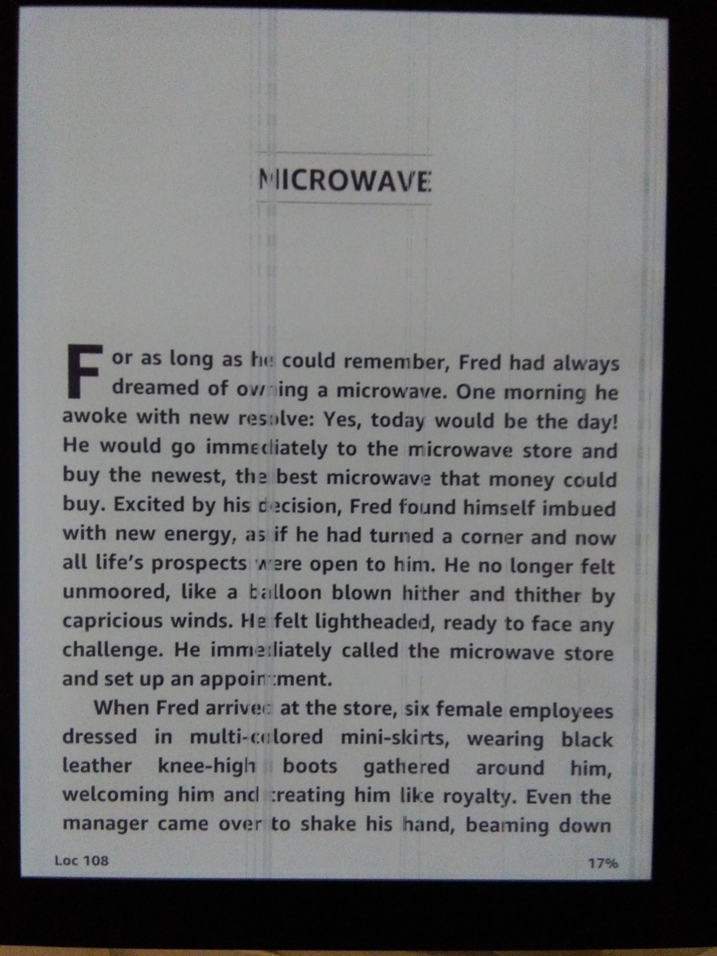

I have an original oasis in beautiful condition with a few vertical lines on the screen (from top to bottom) but only in a few areas. Text on the Oasis is about 90-95% readable.
It doesn't have that fractured, shifted-screen look so common to a cracked substrate.

It could be the screen controller. I had a line in the middle of my old 505 and it was readable, but eventually, have the screen stopped responding. It wasn't a broken substrate. I would say it was a screen controller issue with the 505.

Badly seated flex cable?

^ Likely that.
I've fixed this exact problem on dozens of LCD screens and it is invariably a loose screen edge connector or poorly seated ribbon connector. Quite likely the same for an e-ink display as well.

Yes, an e-ink module uses a TFT matrix layer to address the pixels. The ink layer and drive waveforms will be different but the addressing & connectors will be much the same as an a TFT LCD.
It's worth tearing down, if I can perhaps use my credit card to get in there and check. -- So thanks, everyone, for the suggestion.

ADDED: Here are some images of the Oasis.
ID:	175289   Click image for larger version
ID:	175290   Click image for larger version

When checking for a loose or dislodged ribbon connector, also look for cracks or defects in the cable and I would suggest cleaning the contacts on the end of the cable & connector with an electrical contact cleaner to remove oxidation.
In a minority of cases it may be contacts on the perimeter of the display module that are not seating properly. You can see the effect of this when you press or clamp with moderate force on the display frame.
Junket is offline   Reply With Quote

Well, I took it apart (not all the way, though) and disconnected two cables and one other thing, and then connected the cables back again - and additional lines appeared on the LEFT side of the screen where previously there had been nothing.
Then I disconnected them all again, then reconnected them again and those lines on the left, at least, were gone. The unit now looks exactly like it did before I took it apart.
At least it's not any worse than it was before. I'm convinced it's not the screen, but I don't think the unit can be repaired by someone like me - especially if a cable is bad. This is the first Oasis (2016) and it was ordered and purchased from an outfit here in Peru 3 years ago.
However, it looks like I'll have to say 'Goodbye' to using it.
