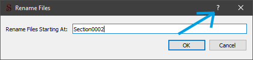

1. Question mark in dialog boxes
Since Sigil does not use QWhatsThis – I suggest to disable the question mark globally. Many of you will ask "what's going on?"
Well, the question mark is in the title bar in Windows in most windows that pop up in Sigil (eg About, Settings ...).
It's about that question mark:
#ifdef Q_OS_WIN32
QApplication::setAttribute(Qt::AA_DisableWindowContextHelpButton);
#endif
Why?
Find "Qt::AA_DisableWindowContextHelpButton" on page: https://doc.qt.io/qt-5/qt.html

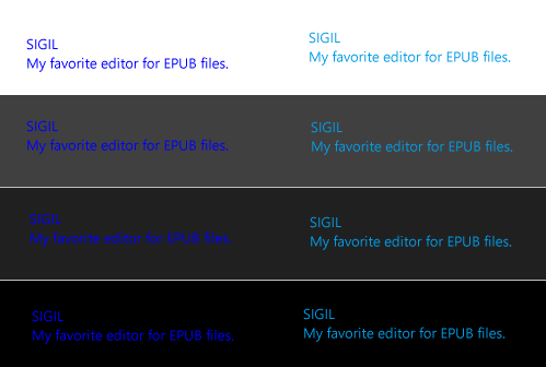

2. Change link color
Standard link colors have been used for years: blue for the standard link, purple for the visited link and red for the active link. These colors can of course vary depending on the web browser and even the specific version of the browser.
Throughout the Sigil code, the link only appears three times (all in the About box), so I hope this is not a revolutionary suggestion.
But why?
The blue color of the link is very legible on a white background, but with darker themes this color does not look good because it is too blue.
The change is simple, just cover these three links with the SPAN tag with the appropriate blue color – I suggest:
<span style=\"text-decoration: underline; color:#039be5;\">…</span>

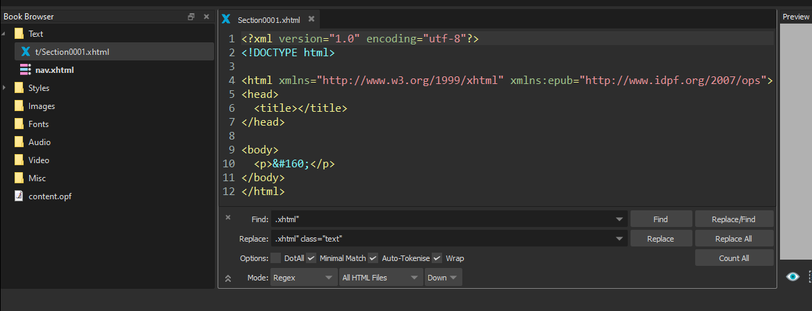

4. Default empty files – a layout more similar to that after mending
It's really a small thing.
Two extra spaces (in two places) and one new line.
Then the empty file before and after mending will be identical.
Separate change for epub2 and epub3.
Image: sigil-suggestion-4.png

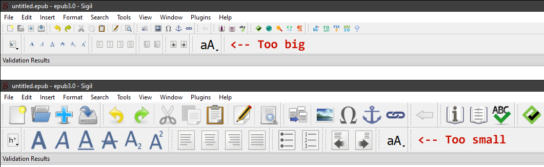

5. Fix format case icon
IMHO the text icon is not cool.
When resizing icons on the toolbar, this icon is either too big or too small.
Image: sigil-format-case-icon.png

#1 is reasonable enough, but we'd need to remember to ifdef it conditionally. AA_DisableWindowContextHelpButton was only introduced in Qt5.10, and we try to ensure that Sigil will build and function with at least limited functionality back to Qt5.9.4 on Linux.
#2. I'm for anything that helps with moving Sigil toward better supporting a dark mode (however it's accomplished).

#5 HOW DARE YOU! I slaved for minutes creating THAT icon! But seriously... I hate icon work, I'd entertain reasonable replacement suggestions (as long as all three necessary sizes were supplied). To be honest, I'm not sure if I did that one or not (or if it's even an icon). I think I did the h* icon.

#5 - I have never felt this icon was too big or too small and am therefore a little leery of changing it, but I don't feel strongly about this.
I just noticed the ? a few days ago. I clicked to see what it actually did, and it looked like it did absolutely nothing.
Just thought it was one of those things that was always there and I just never noticed.
Against this. That specific color (#039BE5) looks quite hard to read on white background, and even inserting it into:
https://webaim.org/resources/contrastchecker/
gives a Contrast Ratio 3.07:1, and fails WCAG on nearly all background levels.
I assume the vast majority has white background and leaves the colors on defaults. If someone goes out of their way to create a darker theme, is this link color not user-adjustable?
Consistency is probably good.
Keep in mind that @BeckyEbook's request is for three specific (and unchanging) links in the Sigil About box (only two of them are actually working links in fact). I just wanted to be certain that everyone understands that this is not a request to make a blanket change to the color of all links rendered by Sigil.
We will try to look for colors that will strike a reasonable compromise RE contrast in Light and Dark Themes with regard to accessibility standards. A triple-A contrast-rating for both modes from WCAG is not very likely to happen, though.
Dark Theme compromises RE Sigil's default colors/icons are going to eventually happen across the board, though; just to be clear. Many OSes already offer High Contrast themes (Windows 10 1909 included) for those who have accessibility needs.

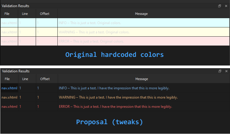

7. Colors in Validation Results
Image: sigil-validation-results-colors.png
System variables are cool, but an even better section would be in the sigil_tweaks.ini file (if the file does not exist – default settings are used).
[tweaks]
border=false
link_color=#3333FF
validation=foreground
info_color=#72A5D4
warning_color=#D4A572
error_color=#DE5E5E
border (#3) – true/false
link_color (#2) – do not like blue or is illegible? enter your color for links
validation (#7) – foreground/background. Whether the color in the Validation Results window is to be set for text or for the background
info_color, warning_color, error_color – own colors in Validation Results

I'd rather not come up with a lot of individual tweaks to address dark theme aspects of various sigil widgets. If at all possible, I'd like to use QPalette generic "darkColor", "lightColor", "disabledColor" for the various ui elements that can then be styled or themed appropriately. One ini tweak file for the validation widget alone seems a bit messy to me.
Qt unfortunately doesn't allow links to be styled
I have thoroughly analyzed the guidelines regarding contrast and visibility for people with sight diseases. Since there is no perfect solution (and perfect blue for links), I have to accept that adjustment for the disabled is more important than subjective aesthetics.
On the other hand, people with impaired eyesight would probably prefer not to use a dark theme, but a high contrast theme. Then the links are often yellow on a black background or similarly highly contrasting.

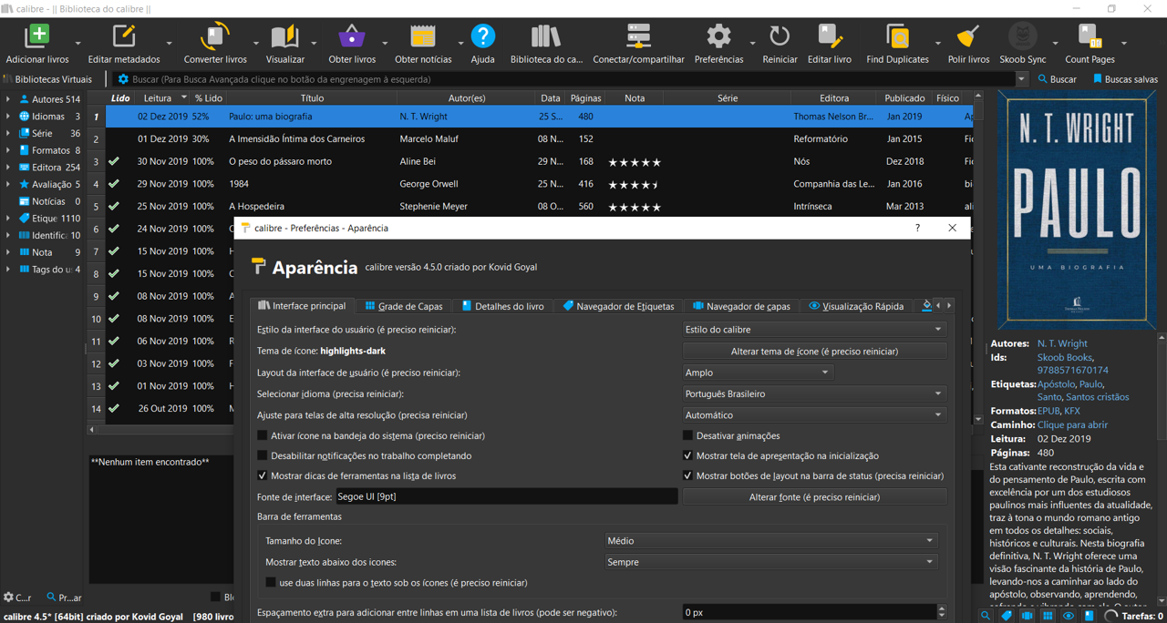

Not sure that's always true, I have poor eyesight and I really dislike high contrast themes. When available I always choose a dark theme (but not bright white on shiny black) - light silver on charcoal grey is my preference, a'la :
BTW that's an upcoming calibre enhancement, as I understand the change, it's what Windows users can (will ?) get if they have selected Dark in Windows->Settings->Personalisation->Colours.
