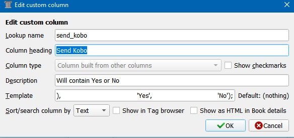

I'm looking to create a custom column based on information from 2 other columns. The end result I'm looking for is:
IF Column A (#keep_read) = "Yes" & Column B (#read_status) = "N",
THEN Column C (#send_kobo) = "Yes"
ELSE Column C (#send_kobo) = "No"
I can't figure out how to adapt any of the "If-then-else" formulas for multiple columns . Or maybe there's a better option; as along as it works!

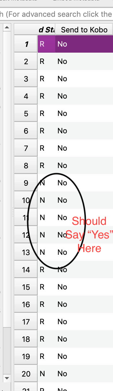

I did get it work, shut everything down and restarted; it seemed to be fine. However, it doesn't do what it says it should; for example, there are multiple books that have the Read Status column = "N" that should say have the new column say "yes", but actually says "no'.

There are also books that in the Keep Read column say yes, but it still says no in new column.

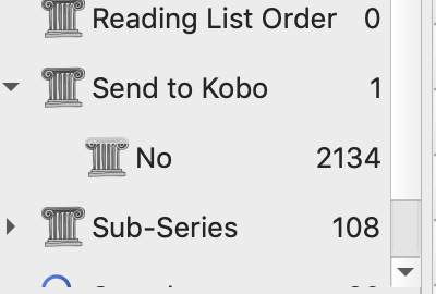

I've just confirmed this with both options; the only result provided is "No".

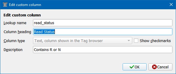

and these column definitions:

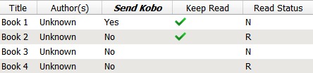

The next screen capture shows the input data and the result. There is exactly one "Y", which is the correct answer (as far as I know).

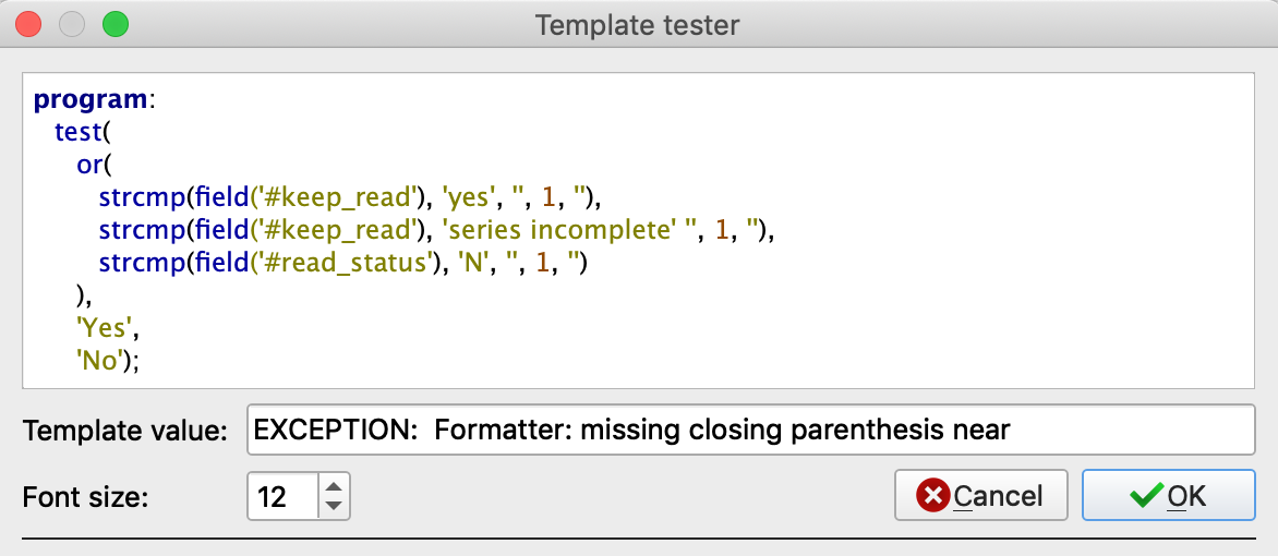

If I could get one more piece of advice though, I'd really appreciate it... I thought it would be very easy to add one more useful piece of criteria to the code, but it keeps telling me it needs a closing parenthesis, but doesn't say where. As far as I can tell, they are all closed.
program:
	test(
		or(
			strcmp(field('#keep_read'), 'yes', '', 1, ''),
			strcmp(field('#keep_read'), 'series incomplete' '', 1, ''),
			strcmp(field('#read_status'), 'N', '', 1, '')
		'Yes',
		'No');
Thanks

The problem is one that gets me frequently. The error handling bits of the template parser are not very good , so the parser can get very confused. It isn't really the parens that are unbalanced but is instead a missing comma.
The corrected template is below with missing comma is in large font bold.
program:
	test(
		or(
			strcmp(field('#keep_read'), 'series incomplete', '', 1, ''),
		'Yes',
		'No');
Glad you got it working.
