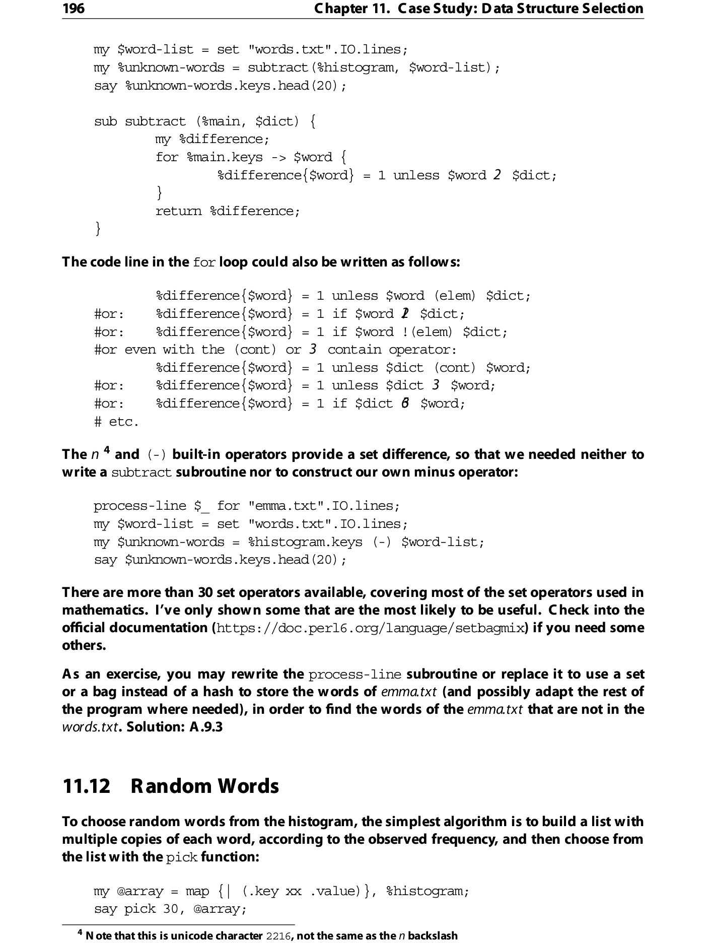

Dear all:
Here's the annoying problem: when I open certain magazines on Inkpad 3, the fonts display the wrong way, with irregular spaces between characters and some symbols not displayed at all (screenshot of a page from New Yorker attached).
All I can add is that I'm using the latest Pocketbook software for this device, and it seems the problem occurred around the time I installed it.

It seems the screenshot didn't attach. Corrected.

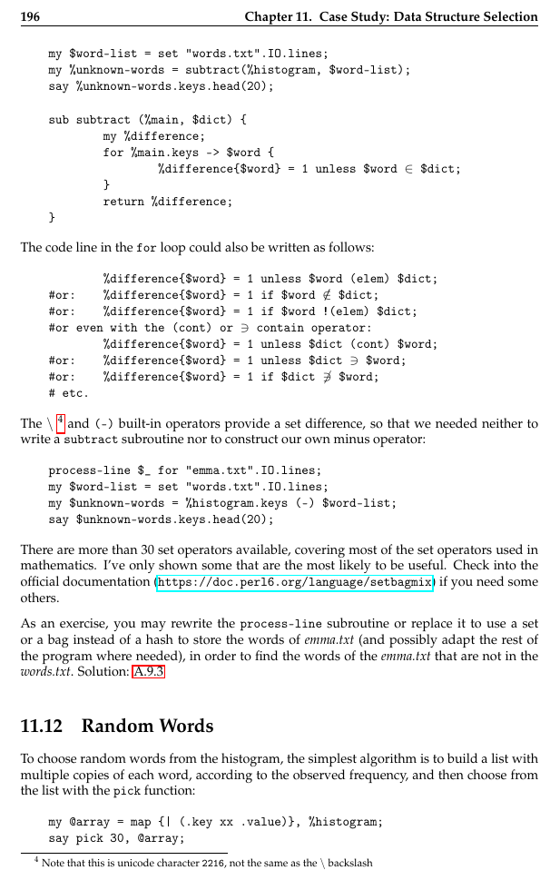

P.S. To my utter amazement, when I opened the same New Yorker file today to check it, it first displayed upside down with bad fonts (even though the G-sensor is off) and then it changed to the the correct font, just as it looks like on my computer screen or on earlier firmware. I really don't know what to make of it: I didn't change anything, the book didn't update by itself, no-one touched the book. The only explanation I have is divine intervention, although it explains little.

I can confirm this bug. I hadn't connected to Wifi for months and then did an upgrade to the latest Inkpad 3 software a couple of days ago, so I don't know which version is the problem.
I have attached a comparative screenshot. The good message for debugging is that the book is open source, so you could have a view at the Latex code: https://github.com/LaurentRosenfeld/thinkperl6
At first, it did not work for me in either universal or fast mode, but after closing the viewer via the task manager and opening it again in universal mode, it works now (i. e., it displays correctly). So it's okay for me now, but still I'm a bit annoyed because it's a software downgrade. Before the downgrade, it worked "out of the box" (don't know whether that's universal or fast mode), now I had to google it and find out about the modes.
Hope this might help you with debugging
